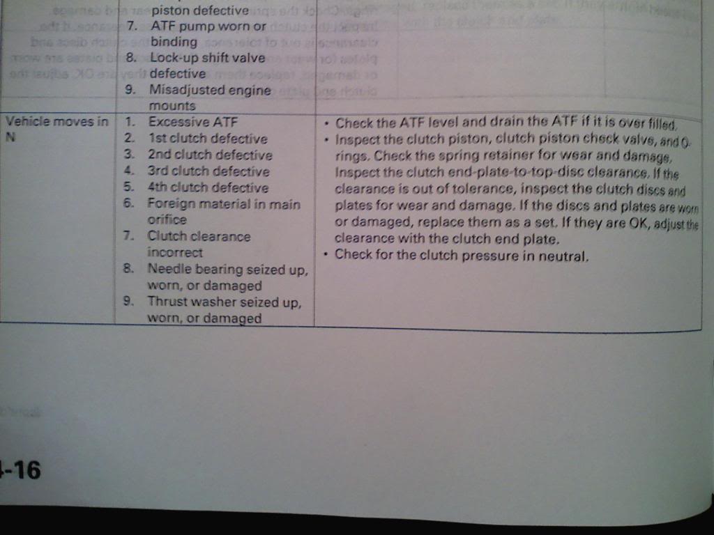

lazlong's Avatar
Joined: May 2010
Posts: 3,662
From: Funkytown, Tx
Rep Power: 235
Re: car wants to pull forward.. in NEUTRAL!?
Sorry, I would have posted this days ago if I wasn't camping for the last 5 days. (It was great by the way)
