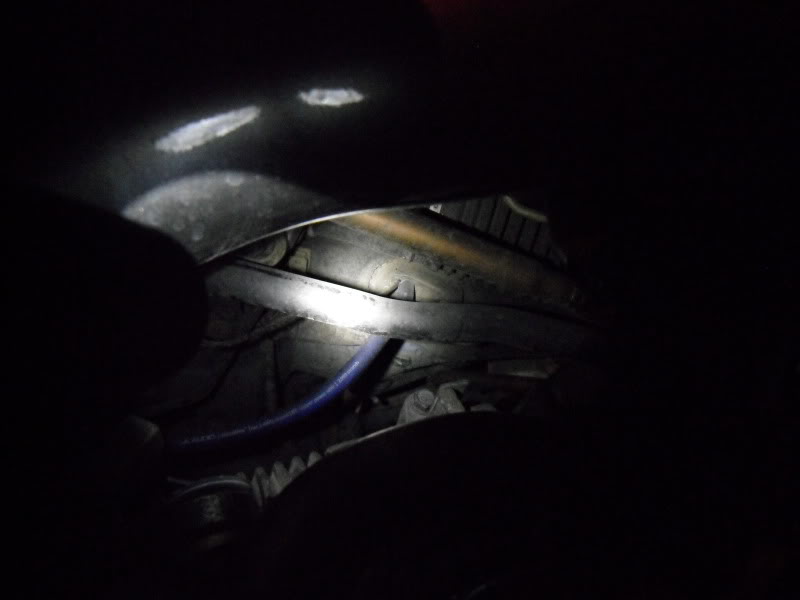

There's a grommet a foot or 2 down that has nothing going through it. I have a 0AWG wire going through mine.
This picture was taken with me standing forward of my battery, looking down into the engine bay.
for reference of the thickness of the wire, it's 13.61mm (0.54") with the insulating jacket(s).
edit: if you pull back the carpet in the passenger footwell area on the inner side, close to the center console, you'll see it.

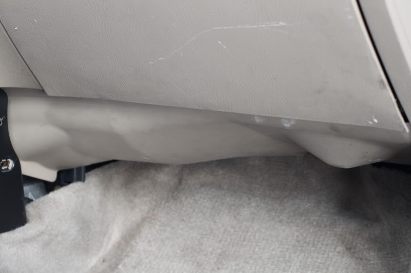

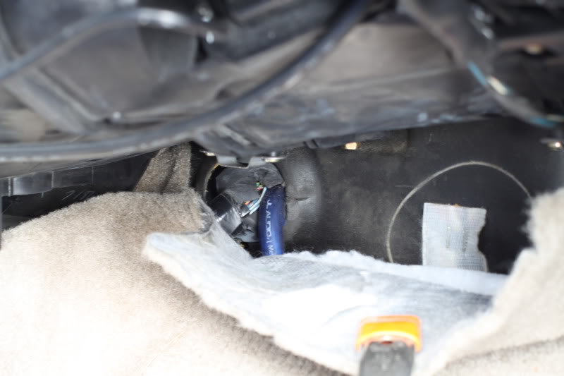

Here's the pics of where it comes through
here's a pic with the plastic piece installed.. You need to remove it to get to it
