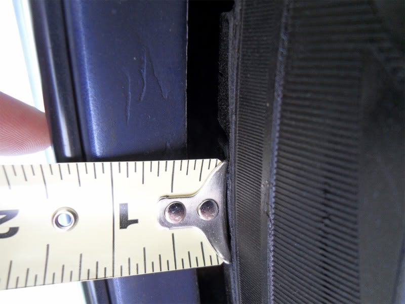

Old Sep 12, 2010
Rep Power: 512
Re: 2003 civic coupe rear tire rub
Before I raised it back up, here's how much fender clearance I had in the back. I had ZERO rubbing issues
Notice the non-rolled fenders
Old Sep 13, 2010
AlexDiduch's Avatar
Joined: Sep 2009
Posts: 23
From: Calgary, Alberta, Canada
AlexDiduch is an unknown quantity at this point
Thats good to hear im running neo gens as well.. i just didnt really wanna chance them if they wore out really quick after just buying them haha
