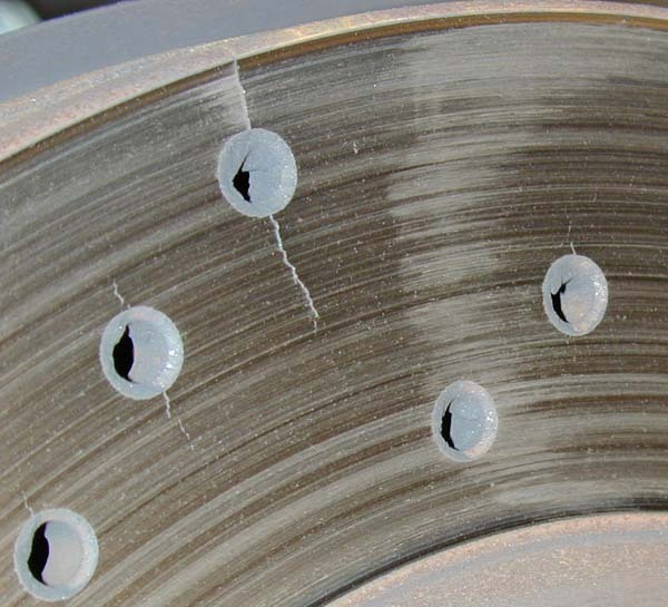

Old Sep 3, 2010
Posts: 15,180
Likes: 1,606
Re: Is there any way to get calipers on my back brakes on a 2003 civic coupe????
see picture below - this is what they tend to do, even some of the most expensives require constant checks if you use them on the track. DD should be fine most of the cases, though.

Old Sep 6, 2010
ExistEvolution's Avatar
Joined: Feb 2010
Posts: 206
ExistEvolution is on a distinguished road
you are right about constant checking on a track driven car and that cracking is usually caused by a poorly made rotor, that problem doesn't happen often, and i have to question what the application of this rotor was, it looks fairly old.
drilled rotors have a bigger positive then negative outlook, yes you lose surface but you also increase cooling for less brake fade. Thats the build up of heat that creates a cushion of hot gas between the pad and rotor.
on another note you're buying a performance part, so you lose some longevity of what a solid disc can do. Also cross drilled will warp faster then a solid disc.
my twenty cents. lol

Old Sep 6, 2010
Posts: 15,180
Likes: 1,606
that's a pic from a miata forum, i used it to illustrate only. not exactly sure about the background of the disc, actually.
i hear even the quality ones could get crackings, from top to bottom of the quality sellers also, including porsches and ferrari's so checking them frequently is a must if you prefer to stop when you want. like stated before and reinforced by you, it's more common to track cars.
The cushion of hot gases does not apply anymore by the use of the more modern materials being used in the pads - just FYI.
