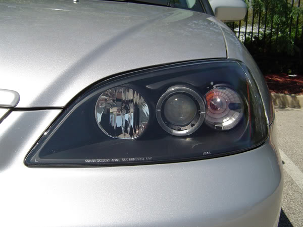

hi...
i bought those projectors and installed them...one question...the bulb more like the peanut bulb/168
oem stock headlight socket does not fit in ...so atm, everything im driving with light and indicators, my extra bulb don't work in it...
how do i fix this? any help..
i have a 2001 civic ex (si in canada)...

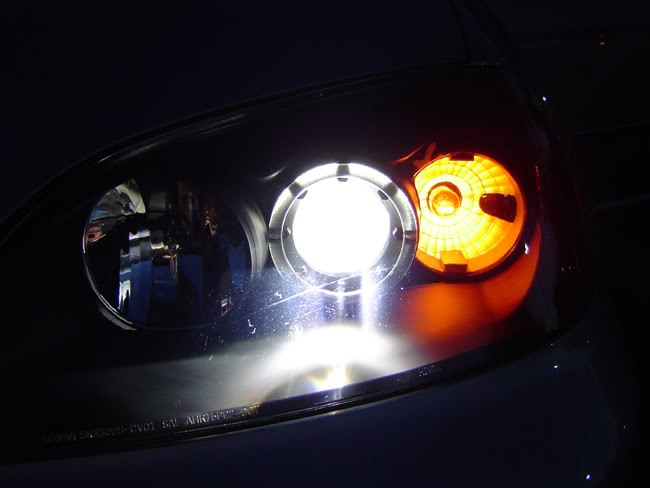

i used to have those. the oem turn signal and park light socket/bulb (7443) should fit in the main hole and work as both park and turn like it does already in the oem light. the tiny park bulb also has a place on the side but is not necessary. i left it out cause i think it looks better just as a single bulb. if the oem socket is loose, grab an extra o-ring and double it up.
