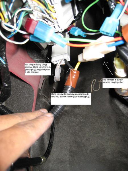

you can see from the picture which plug he used. at the end of the sub harness theres a yellow/black wire connected to a plug, pull the black one out so its just the yellow one left (thats what he did as you can see in the picture) and slide that black one into the existing car plug. if you look closely at the picture, the car plug has 4 little spots, and the middle two wires are blue/white and green/red. the wire should slide and lock in.
still not sure why its done like that, i dont have this kit installed so i dont know what that wires for. i probably would have done it another way if i knew exactly what that wire was.

Yea but on his plug it looks like there is only the two wires in it, in mine it is full...idk I will look again

Yea, I know what he did as far as pulling the wire, etc., I didn't have a problem with that, I have the wire pulled from the plug my problem is where to put that wire on the existing car plug....bc his plug in his car has two wires in it and it is an 8 pin harness, whereas mine is an 8 pin harness with 8 wires in it, I am so pissed b/c it is the only thing I need to get them to work. My car has k20a2 swap but that should have nothing to do with the harness being full under the dash.

you sure you are looking at the right one? i looked again at the picture very closely. it looks to me like a 4 pin harness. slots 1 and 4 look empty, slot 2 is blue/white, and slot 3 is green/red. that little part underneath looks like that part you pinch with your finger when you unclip the harness, it doesnt look like you put any wires there. maybe take a better look because to me that doesnt look like an 8 pin harness.

Yea well my harness in that same exact location is an 8 pin and every slot is full so idk what the hell I'm gonna do

The only picture I see is the one unTuned attached, not the from the original post. Since your wiring harness is different I would suggest just using a volt meter to find a point to attach to.

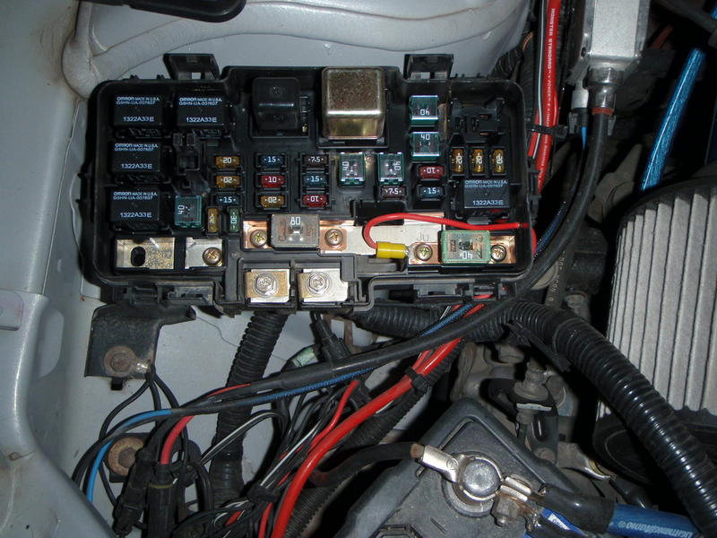

if you dont want to actually tap into the cigarette wire itself (which is something ive always been against) you can do it a much cleaner nicer way into a fuse box. you can use the fuse box under the steering column, or extend the wire through the firewall and go up into the engine bay fusebox (thats how i did my undercar lighting). ive attached a picture so you can see how it looks nice and clean too.
its the ride wire coming through the side. i drilled a little tiny hole through the side of the box just big enough to fit the wire through, then put a ring terminal on it and connected it like that to the fuse. youll have to figure out which fuse you want to use if you want to do something like this but its just another option.

I'm not sure why running a wire under the dash, through the firewall and to the fuse box is "a much cleaner nicer way" than running a wire 3 inches from a switch to a power source. I modified the spade on the end of the fog light wire so that it clipped onto the 12 volts wire where it attached to the cigarette lighter and the used heat shrink tape.
There really is no one right way, the only important thing is to have good, tight connections.

yes, it actually is a much nicer and cleaner way to do it in my opinion, but like i said i was just giving him another option.
i was showing a picture to explain how i did mine (which was not even for a fog light setup) so yes, i ran mine through the firewall and up to a larger and stronger fuse. if you read what i actually said "you can do it a much cleaner nicer way into a fuse box. you can use the fuse box under the steering column" you would see that i am fully aware of what he is trying to do. the picture was to show how i hooked up into the fuse box rather than tapping into an existing line. not to specifically tell him to go through the firewall and up to that fusebox.

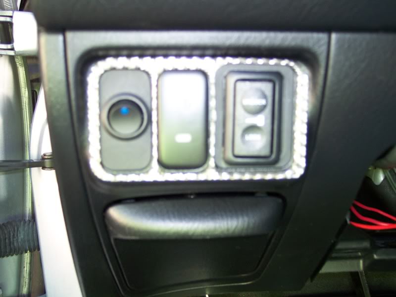

I put my switch on the left side of the column on the dash?
the little blue-dot round switch is interior blacklights, and the other one is home-grown power door locks.
