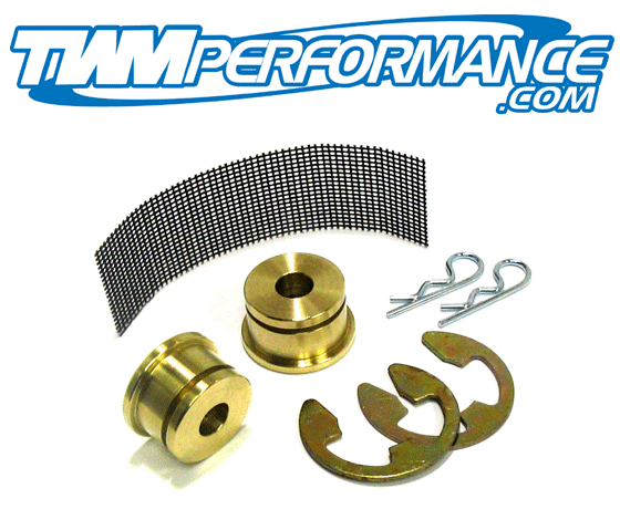

Twmperformance:

Now You see how twm has only two, are you telling me that I use two busing for each cable from strutking?

Yup, you sandwhich them together and the end of the cable grabs it in the center. Its in an odd spot thats not very camera friendly.
Here are some pics I dug up on the twm bushings... The more parts, the greater the chance somethings going to go wrong. (Wow, they look wack!)
