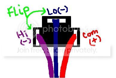

Originally Posted by fiend
i asked a guy i work with who knows alot about everything when it comes to hondas and aftermarket parts. when i got my new kit, i let him have my old ballasts which were also a single beam kit, he bought bi-xenon bulbs and the bulbs came with an extra wire, the wire you need to go from low to high beams. the single beam kit has only 2 wires that you plug into that connector piece (not sure what the technical term is at this moment) whereas the bi-xenon has 3. he said he did it, bought the bi-xenon bulbs and it came with that wire and they work, so, i think i'll try it, if it doesn't work, well then, my question will be answered lol
yes, the H4 plug has 3 wires, High beam, low beam, ground. This is the connection between the H4 female socket (from your honda) to the H4 make plug (on the dual bulb). It does not affect the ballast in any way.
see pix:
