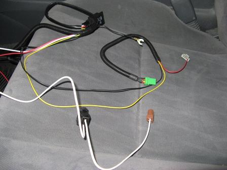

I bought a set of Fog lights for my 03 civic LX from Ebay, and followed the install in the DYI section, the only thing that I am not sure of is that in the harness inside the car only have 1 wire black that is the ground, and 2 connectors that i am assuming connect to the fuse box under the steering.
Is that correct?
In the DYI section there's more then 2 connectors, so I was not sure how to wire them, or give power.
can someone help please?

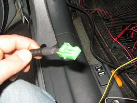

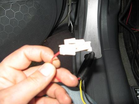

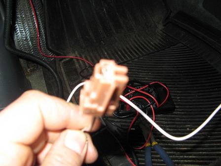

I took some pics did not have a camera available with me at the time so here are some pics that i have uploaded.

Green goes to your supplied fog switch and is apart of the "switch harness"
The brown clip plugs into the underdash fusebox. look for a two vacant spots side by side above two relays(big black boxes).
White clip with red wire goes next to brown clip and you are done!
Make sure all connectors make contact with the contacts! Mine didn't and needed some little modifications.

Well i did exactly that with the wiring, and unfortunatly form me it did not work.
Tested the connections in the fuse box and all is good, ground is good.
nothing is happpening when i try to turn on the lights with the switch.
Damn.

Take pictures of your whole set up. I think you might have put the wrong wire in somewhere.
At the same time, did you check the rest of your system for any abnormalities?
