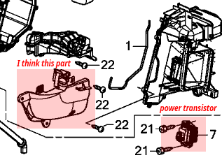

I am assuming busted resistor but I couldn't check it because some plastic guard is blocking and I don't know how to separate it...
is there anyone who knows how to separate this plastic guard?
You mean the panel under the dash that hides the important stuff? Pull the rear edge straight down.

and this is the photo of that plate which covers power transistor. I have no idea how to separate it
Remove the glovebox from dash
remove screws (3 ?) for the small plastic duct, remove duct.
Now you should be able to reach the power transistor and its connector.
Can I just unplug the power transistor and test it?
Yes
Check maximum fan motor speed:
unplug the power transistor and connect its two largest wires together, that should cause the fan motor to run at maximum speed
If this makes the fan run much faster than it had been, then I'd suspect the transistor.

Is there anyone who knows how to remove that plastic ducts ?? video or photo? it doesn't come out for god sake even after removing 3 screws

I couldn't test a power translator because of that plastics I think I should remove passenger side dash with the glove box. rather than removing those plastic things (I removed three screws which I can see but it doesn't come out easily it's like this things are saying that don't touch me)
