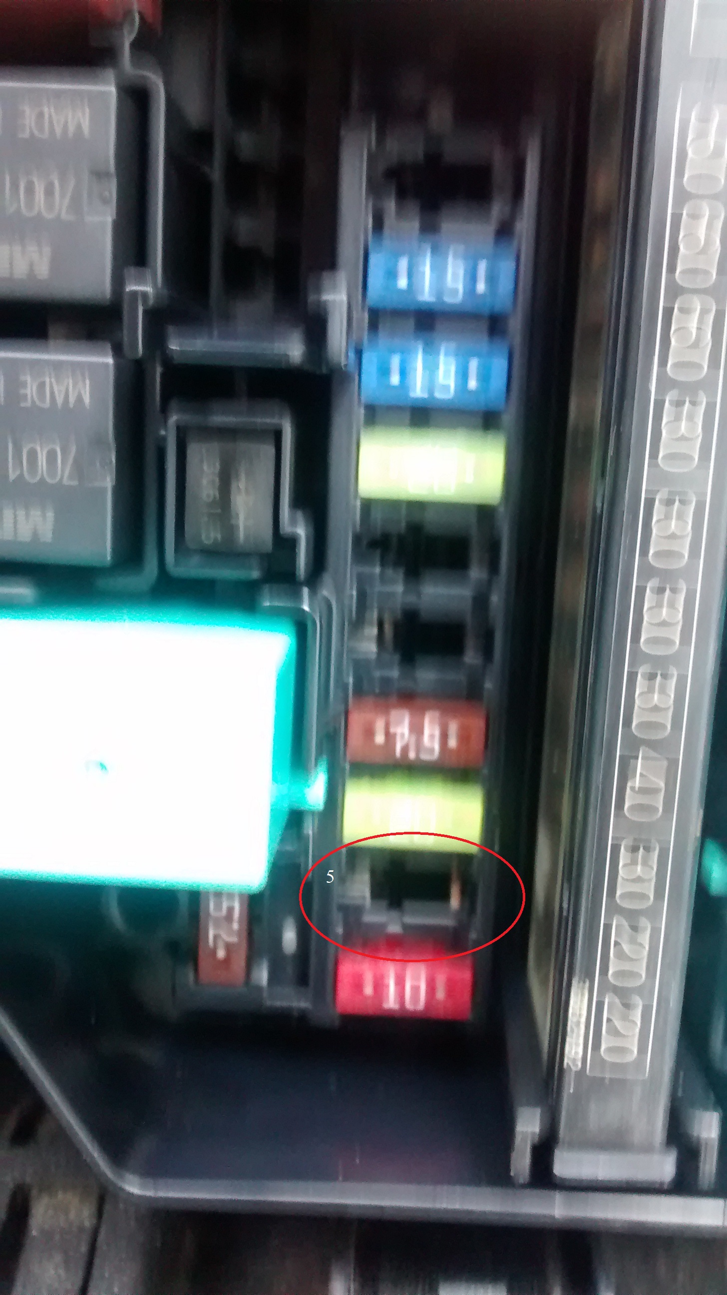

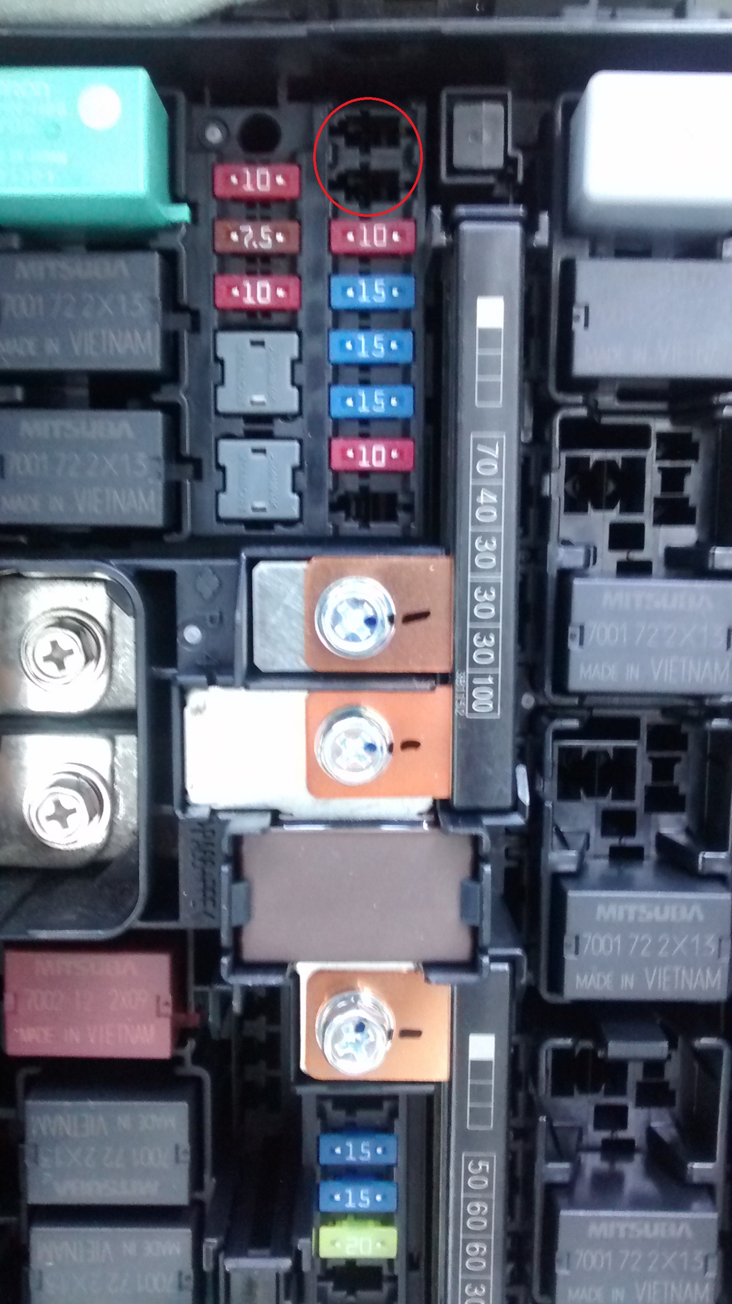

No fuses on # 28 and # 29
Could be any of the relays stuck after I stop driving the car?

So you've pulled out fuses 28 and 29, now your 500mA draw is gone? (a lot more than just interior lights should have been disabled with those fuses removed)

No. There are no fuses or metal connectors on #28 and #29 at all.
The power of 500 mA goes down to almost 0 after I close the door and wait 20 seconds.
Obviously some times this doesn’t happen and drains the battery. Could it be stuck relay?
I didn't replaced anything in the car.

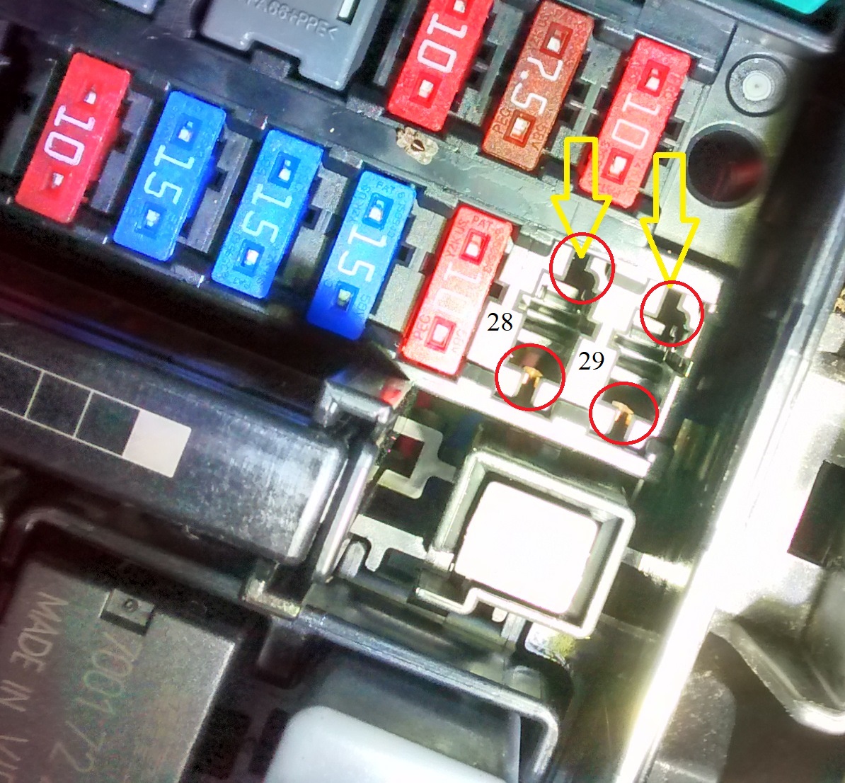

There are no metal connectors on one of the sides of # 28 and # 29 slots ( Yellow arrows ) Placing fuses there will be useless. Trunk and inside lights are connected to fuse # 5. The lights don't work after removing it.
Is my model different than the ones you are familiar?

Where's your 500mA draw fuse #5 at in the box?
The fuses 28 and 29 are shown with a heavy outline on the lid diagram and you circled it in one of your pics, those are the fuses we have to install during new car check in before they go on the lot for sale.
There should be fuses there on every other car, why would yours be any different if it's all stock?
Install those two for s&g anyway?

No change with or without fuses on #28 and #29
