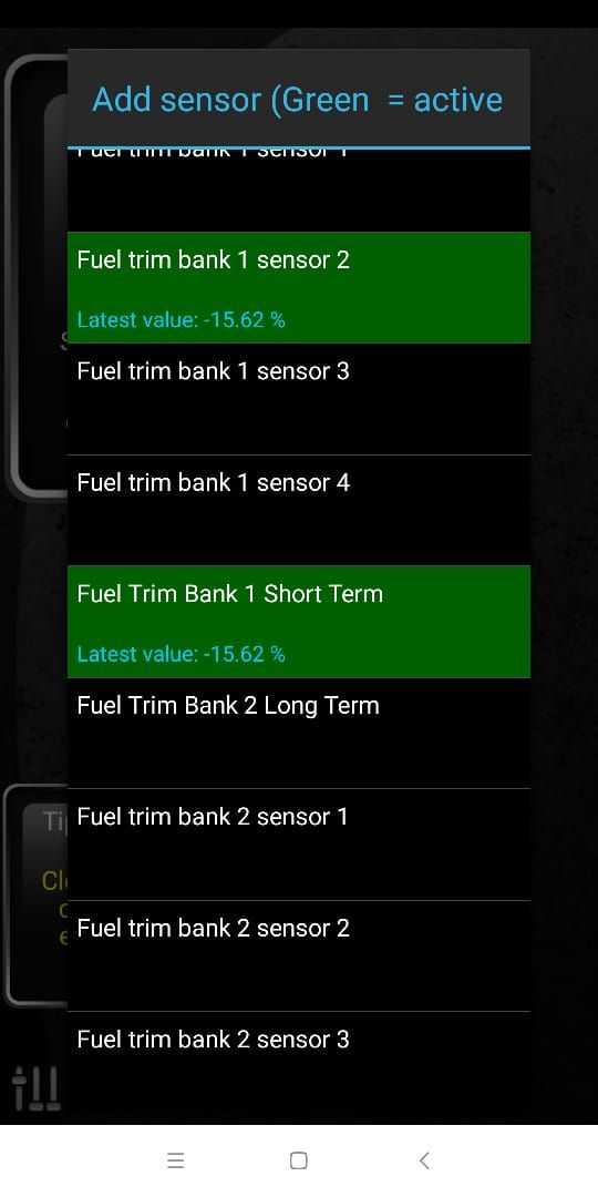

4. Short term fuel trim is always and greater than -18%. upon 2500 rpm it is 12%. upon cold start, it is -20%. when the engine has warmed up and moving at normal speeds its fluctuates between -12 to 18%.

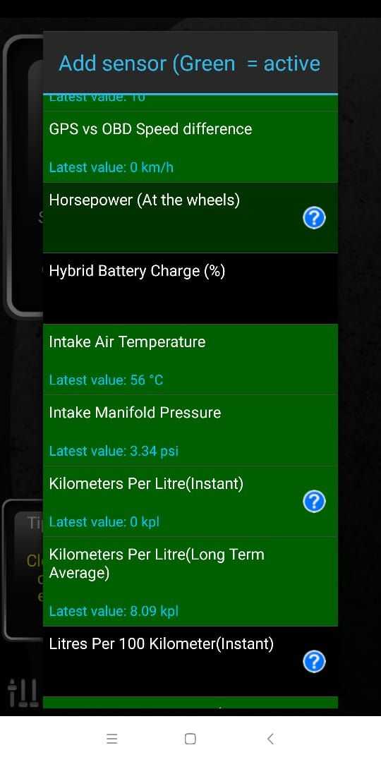

The below are the screen shots at 750 rpm.
THE BELOW ARE THE SCREEN SHOTS AT 2500RPM.
The below are the screenshots at 2500rpm.
