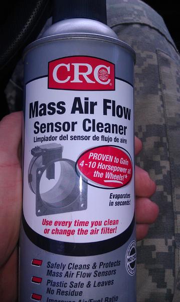

Hopefully you were careful with your MAF when you removed it then installed it on the AEM. I mean of course you didn't drop it in a pan of oil after tripping on the box it came in, but if you did, or if the filter had to much oil from the filter on it just clean it with some Mass Air Flow Sensor Cleaner. It's very specific with cleaning the MAF, because its particular about what you use. Or just a vac line, either not connected or even slightly kinked disrupting the airflow. Another thing to do is pull the negative cable drain the power in the car, then retrain the idle. Autozone will pull your codes for free.
