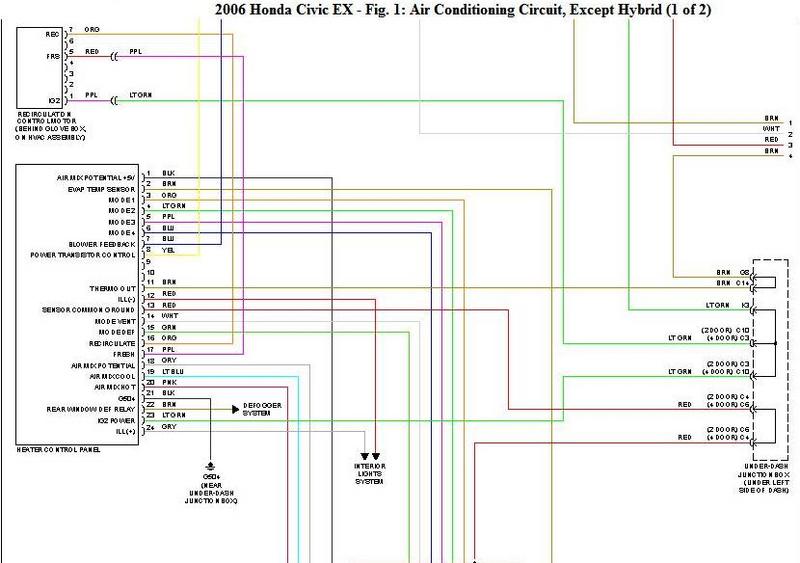

So my genius friend the other day, somehow managed to pull about 5 wires out of his AC harness plug. IE. the one under the radio. I still haven't figured out how he did it. But does anyone happen to have some pics, a wiring diagram and can they tell me what the wires do? lol. Im just trying to fix it for him.

Let me know if this isn't helpful enough and you need the rest of the diagram. I'm not exactly sure what all you'll need to fix it.

Yup that'll work

although thats 1 of 2 just curious what 2 of 2 is lol

Nothing but relays and motors.
