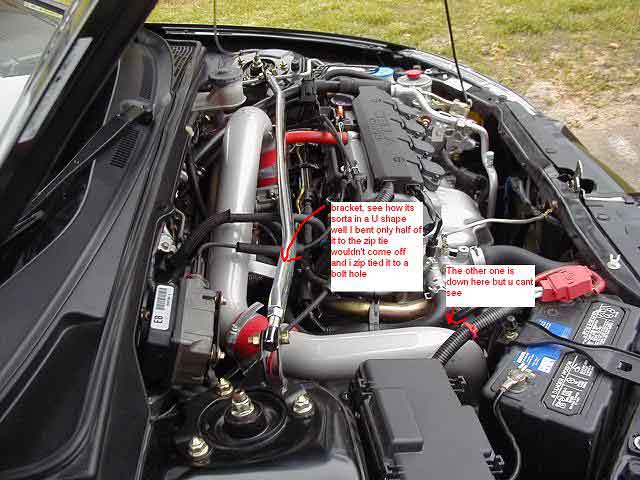

Hey, I used zip ties to keep it in place...They are working Very well...For the first bracket the one closest to the TB i bent part of the bracket up so the zip tie wouldn't fall off...For the bottom one i didnt' have to it stays in the U shape of the bracket and i zip tied it to the nearest thing....Make sure the zip ties are very tight to where the bracket doens't move at all..
Pic attached, but you cant see cause of the strut but it ill still give you an idea...

oh yea, also cut the rubber coupling, the one that hooks the intake to the TB, this is so the hood doesnt scratch up the piping...plus if you install a generic strut like mine it wont rub the rubber tubing to the engine...
EDIT:
Oh im sorry i didn't see your post said that the intake had no brackets...I bought mine for 50 and mine came with brackets...Look for another seller....I did have mine loose in the engine for a while, doesnt really do any damage..just to the piping mabye (scratching it up)
And if you compare this to an AEM its not the same, the AEM piping is thicker in diameter I think
