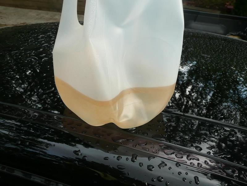

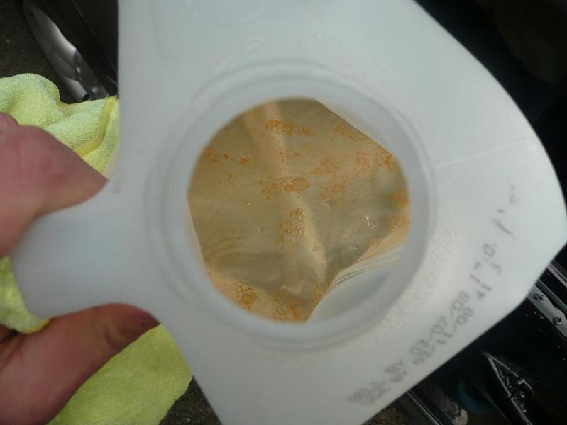

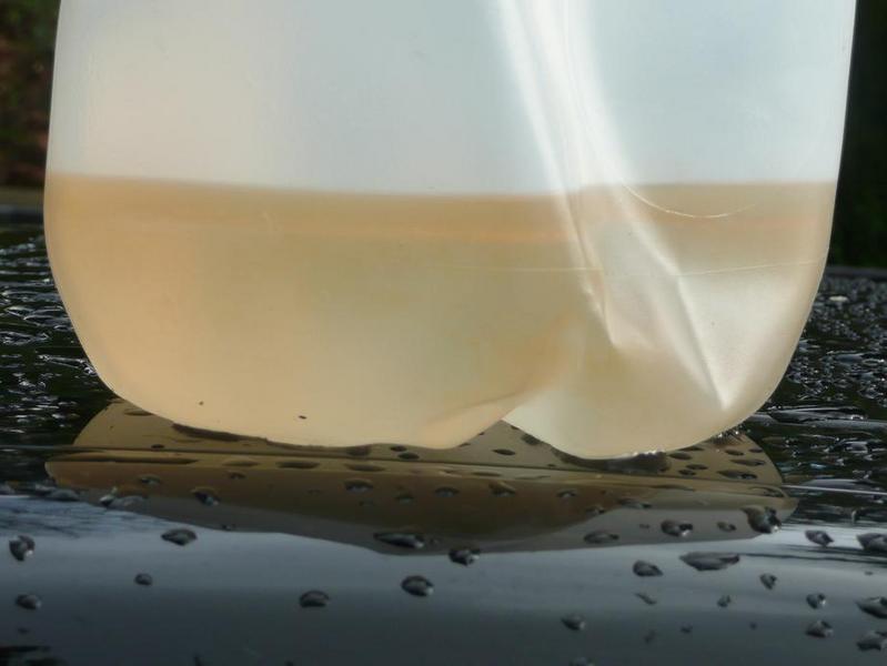

Ok guys, I wanted to post some pics before tearing the car apart..
Let me know if you think this is still water. I spoke with the local race fuel store guys and they said that water will distinctively sit at the bottom, and if it's yellow, it should still be fuel...
I may have some water, but is it obvious that I have a significant to worry about?

Why on earth did you put that in there? Relieve the pressure and flush it out with clean gas, run fuel system cleaner that is designed to remove water, and refill. Should be good.
Expensive, to waste all that gas, but what are you gonna do?

That doesn't answer my question. Is that gasoline + a lot of water or is it mainly gasoline? The impression I got from the gasoline distributor is that it should be distinctly water..

Is anyone else here that has the knowledge and experience to look at the pictures and say deffinitevly whether there is significant water or not?

put it in something other than a milk jug...like a glass so that we can see the bottom clearly and if there's water you will be able to see a distinct line.

Your civic is mad at you for setting that milk jug of crappy fuel on it.
-JUST KIDDIN
Really Ive removed much worse from previous work. A CRX of mine that I got at a deal The gas tank was rusted the f*** out. Now do you think that gas was good... no. But you remove as much of the problem as you can and do the best you can to fix it. I had to replace tank,injectors,filter,pump, you name it.
If you purge the good portion of the fuel,and you only have 1/10th of a tank anyways(I believe that's what you said previously) The fuel neutralizer will take care of the rest. After a few fill ups, and some normal driving, you should be fine.
Your problem is very simple, just be glad some ******* didn't pour sugar in your tank.
