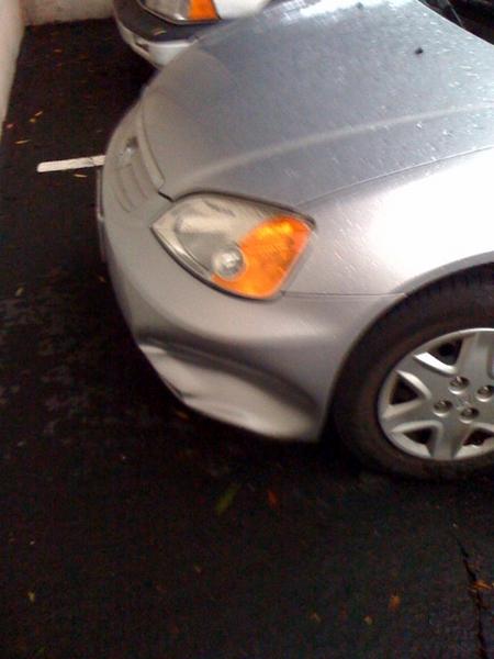

This was a dumb mistake. I accidentally drove my LX into a snow embankment .
I'm thinking that I might be able to fix this on my own but I may have no idea what I'm getting myself into. There is no paint damage, but who knows, some paint might chip away if I try and push this back into its original position.
I searched and searched but cannot find any DIY directions on how to get my hand or a rubber mallet to the inside of the front bumper.
Please help. Thanks a lot!

It comes off in 10 minutes just take it off

yah the bumper cover is easier to get off than you think.. look up the diy for painting headlights and it'll show you.. I think you could fix it w/ a rubber mallet.. Honda tin cans FTW!!

liek everyone said, take off ur bumper, and just push the dent out.

use a hair dryer to make it warm and plyable and then push it out, you risk cracking the paint when its cold...
to take the bumper off, open hood, there is maybe 4 clips you need to pop the center out with a screwdriver. There are several more of these clips underneath the bumper. In the fenderwell there is also one (i think) and a philips screw up top. undo all of these and pull from the fender to the other direction, its stuck in with clips and needs light force. Put a towel down so you dont scrap the bumper when it drops off.

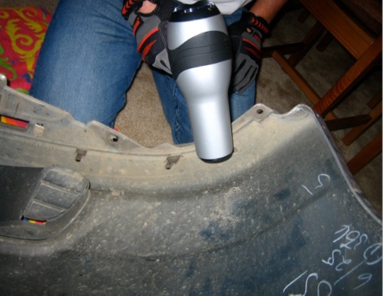

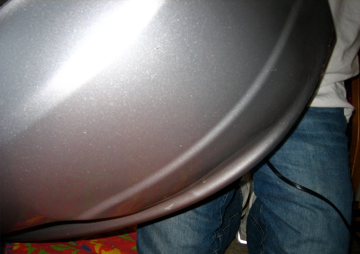

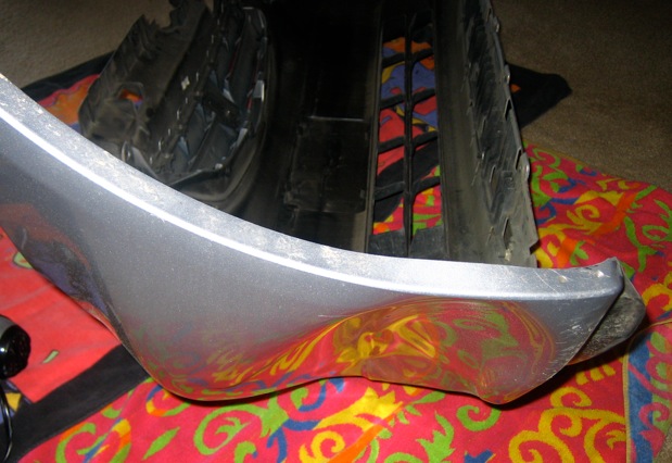

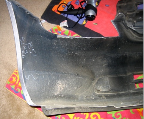

Thanks for all your help. I got the bumper off in about 10 minutes as suggested and followed these instructions:
6 things to remove from the bottom:
4 regular size snaps,
2 screws,
2 large size snaps
4 things to remove from under the hood:
2 things to remove from the wheel wells:
2 screws (one on each side)
I brought the bumper up to where I could use a hair dryer, heated it up, and it pushed smoothly back out in place. It looks almost as good as new, unless you look at the area within ~10 inches.
Here are some pics before and after. Thanks again.
