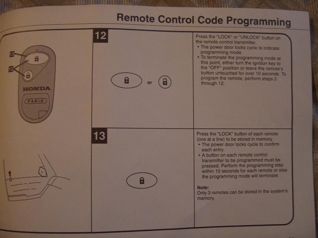

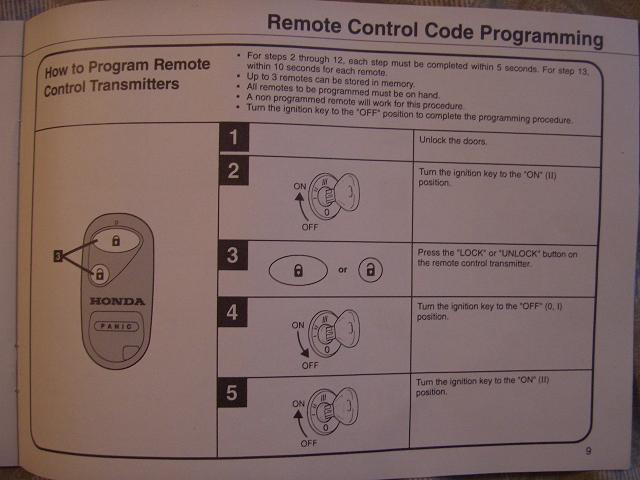

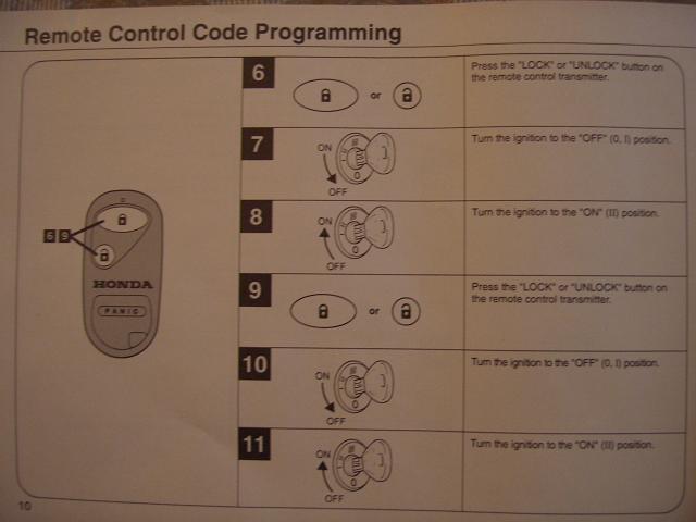

ill try to find it for you. If I find it now expect a reply in 10 mins or less. If not tonight or tomorrow morning.
Old Mar 3, 2006
diskreet's Avatar
Posts: 8,839
From: PA
Rep Power: 362
ID:	64823   Click image for larger version
ID:	64824   Click image for larger version

thx man .... i got a remote with the trunk button is from older model
i try i when i get home and tell u if i did it

i tried and it didnt work ..... maybe cuz the remote is from a older model..
Old Mar 4, 2006
diskreet's Avatar
Posts: 8,839
From: PA
Rep Power: 362
its not a civic remote so it wont work. You also obviously need the keyless entry reciever installed too, but once again it probably wont work for a civic.

the remote its from a civic only older model 96-99
