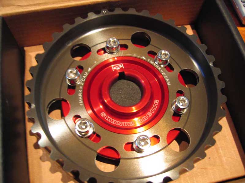

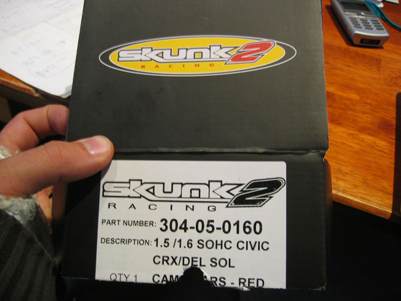

It's QJP email them.
http://cgi.ebay.com/ebaymotors/ws/eB...sPageName=WDVW
ID:	55372   Click image for larger version
