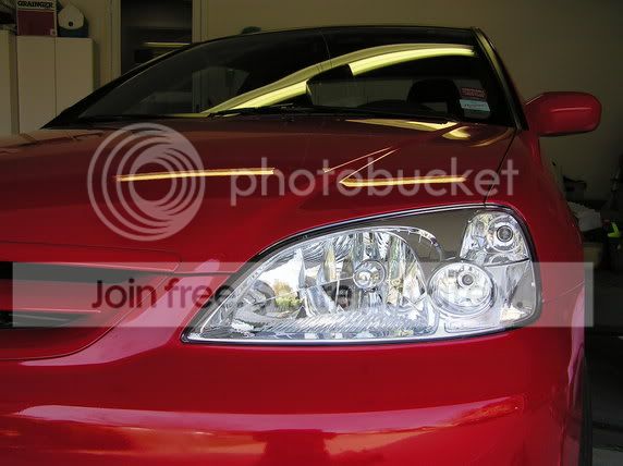

anyone has a picture of the result?

Here's mine, did it about 2 weeks ago. Such a huge difference. They look so nice.

^^ those look really good!
Here are mine.. But I kept the orange part and tintied everything with black tint spray.
