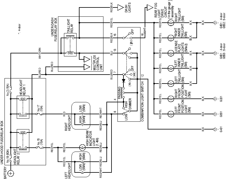

Here is the circuit diagram:
Had to upload it sideways because 7thgencivic only allows 800x600 pics and this pic was to larger horizontally.
