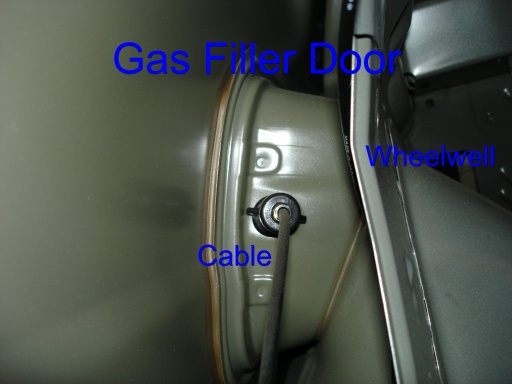

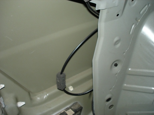

Aight here's what you'll see behind the carpet.......one cable going to the trunk latch, and one pressed up right against the left quarter panel of the car.
The cable that goes to the gas-door, give it a little pull.......if it's attached is should work when you pull it manually. If not, it's gonna come off in your hand and if the actual cable isn't broken, now you can see where to reattach it. Not too hard if I remember correctly.

Hey, that first picture is great for people that get water in the trunk. That's the area that honda forgot to properly seal on some.
