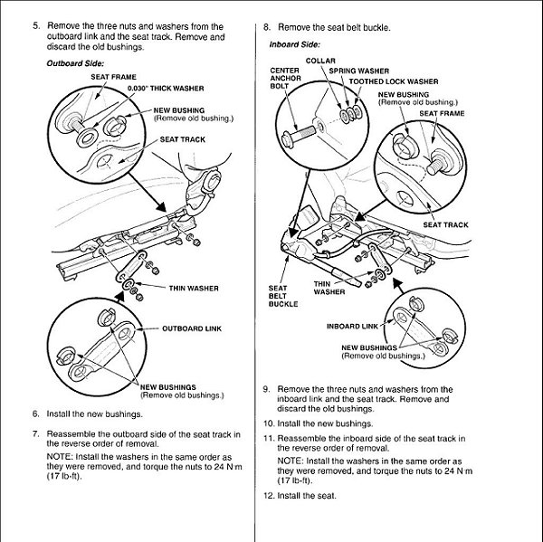

In case anyone else needs it..
ID:	47561   Click image for larger version

Its by far the most irritating thing in my car, especially in stop and go traffic. I already had this fixed once under warranty, but i've just been dealing with it since my warranty expired. Does anyone have a pic of the bushings? I'd like to find something a little more solid to swap in there, I don't care if the height adjust works or not.

I have the same prob and since my car is out of warrenty, they won't replace them. Has anyone replaced the bushings themselves or has anyone been able to purchase the bushing kit from Honda?

well I am going to call honda tomorrow and see if they have them. *** taking it to honda, I will do this myself.
