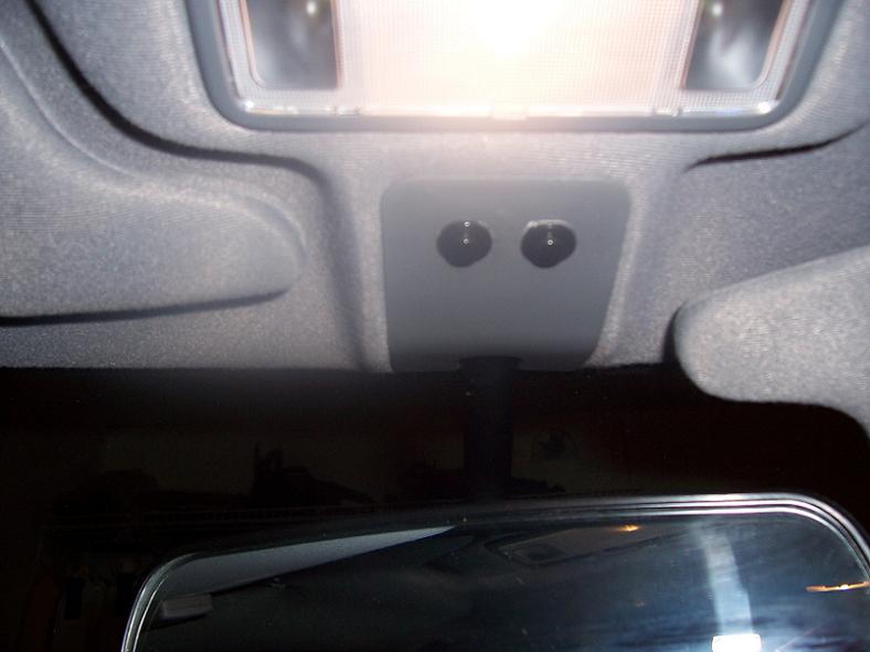

Just discovered this thread and wanted to post my pics. Three weeks ago I did this, but instead of wiring to a 12v source I just secured the whole garage door opener, batteryand all, in the headliner, then I removed the old swiches and extended the wires to where it would reach the rearview mirror. But after i drilled the holes in the little plastic thing i realized that i couldnt put it back onto the headliner so i had to grind the mounting piece for the rearview mirror down half and inch so that the swiches would clear. Works like a charm.

  #80
KnocturnalEM2's Avatar
I am your Mom's Hero!!
Posts: 1,536
From: ~Nor Cal~209~
Rep Power: 290
Hockey that is sick!!!! I like that!!! Old thread but still some good ideas!!!
