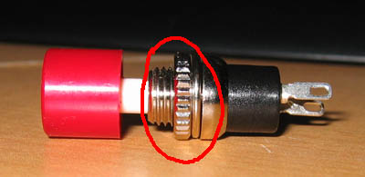

what size hole did you drill and what keeps it in place?
Old Aug 16, 2004
  #38
dirtySAMURAI's Avatar
I log in from time to time
Posts: 15,682
From: VA
Rep Power: 436
17/64 inch drill bit. if you purchased the same button as i did, then you will notice that it has what looks like a nut on the base of the button (circled in red below). it twists off and you use that to hold the button in place.

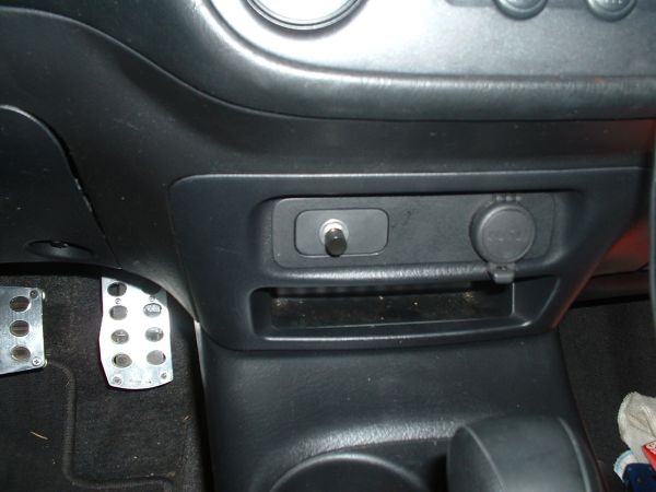

I Did It!!!!!!!!!!!!!!!!!!!!!!!!!!!!!!!

awesome dude! that means only 1 has failed.
Old Aug 16, 2004
  #43
civic2uner's Avatar
Posts: 1,207
From: Arkansas
hell yea
i love it.
