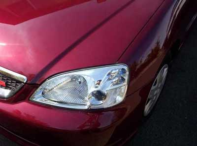

The best thing to use is a heat gun. I did that but becareful it gets super hot. Once you clear it, you have to use cement glue and silicon. Once u glue it, silicon it and let it dry overnight. The next morning, silicon it again, if not then it will fog up inside. If you got any questions, PM me. I attached a pic of the finished product.

hey vietfob, what color is your civic? looks purple-ish from that angle, but maybe it's just the light. looks cool...

Its like burgandy red... not my car its my fiance's car or i'd like to call it ... my toy
Hey Hassoomi If you click on the my site button you can see the whole car
