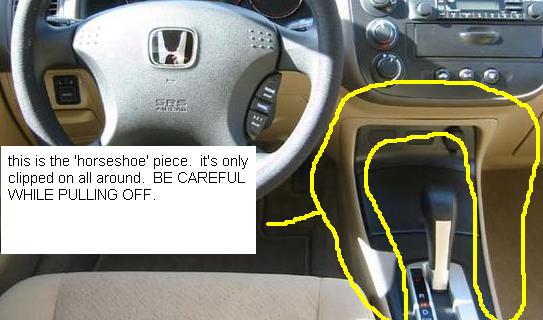

you didn't mention earlier that you took the shift boot off. Unscrew the ****, and pull off the shift boot and its surrounding panel. I believe there are two more (see part # 30 in diagram) screws underneath, that screw onto a silver bar (part #20?) that is bolted onto the car frame.
I think you may have hinted at it, but make sure you also take of the plastic horseshoe piece that wraps around the cigarette lighter panel and attaches to both sides of the center console (it gives the center console and the lower part of the dash, a perfect fit and connected look). It's only clipped on, but becareful because it's plastic and it whitens if it get pressured.

here's a pic

I'm not sure, but I believe the cigarette panel is part of the lower dash (just like in 2001 and 2002 models), not the center console. the horseshoe piece keeps the center console and the lower dash together and it looks so smooth.
