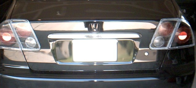

These are my tails installed... the pic isn't that great because it's dark outside... but i left the corner lights without the cover so they are 3D...
tell me what you think... i'll try and get better pics up...

can you give more instructions and a better picture?
looks good from that small pic

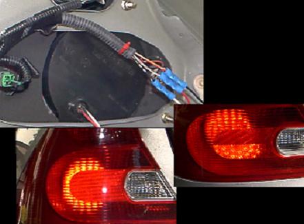

Here is some PICS that you wanted ... sorry that they are kinda vague ... my dad has my metric tools so I couldn't get the lights off for better PICS....
I basically used a "roto-zip" type bit to CAREFULLY trim out the size necissary to insert the LED module, in my case I went with the school bus type fixture, they are super bright, and priced reasonably. after the hole was trimmed for a snug fit, i simply slid in the module and silicone it up.
*as a note, do not silicone it in place until you have mounted it to see what angle it has for best visibility from behind, my first attempt ended up in the best line of sight at a 3/4 view to the rear end of the car and not the brightest from directly behind. also, when mounting any chosen module, you must check for clearances to the trunk supports. this will also be a factor in where you can actually place the module in your OEM housing. well hope it helps
