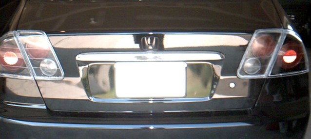

Here are a few
Here is two pics. The cover is not on yet, and I have to clean out the clear piece because it has some super glue inside it (I actually dont know how it got there). I painted inside the pieces, so that the silver underneath the red and clear is black.

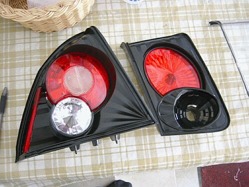

Here is the second, much better quality photo.
Oh and one thing about taking out the red and clear piece (or just big red piece) before you paint is that you should be careful about breaking the tabs, if you pry up quickly the tabs break and you wont be able to glue it back in conventionally.

This is a pic of my tails after painting...

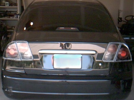

Wow, you are a much better painter than I am. I couldnt find a sterile area that would be well ventilated, so I had to do it in a dirty area, plus, my spray can was running out at the end and I had no extras (I can't afford another right now), so I just used it as is, it looks alright. Not that clean, but in time I will fix that.
As to leaving it open, you have to have some good paint and be a good painter to have confidence that the paint won't chip, etc. But when I clean it up I might try that.
Here is a pic

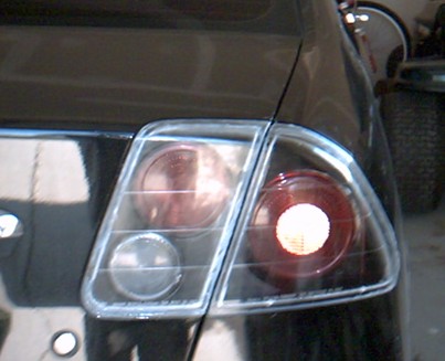

Here is another pic.
BTW, I am getting the silver strip along the back in black, so it should look a lot nicer.
Oh and about flat black, maybe it would look better, but I got the matching black from factory paint and sprayed down two coats, then I used a clear coat for 3 coats. So maybe flat black would look better, but I'm stuck now (and if I wanted to leave the plastic out then I would need clear coat).
Also, my camera sucks, so the color is distorted a bit, if you see my car in person, you would see that the color of the car matches the tails almost exactly.
