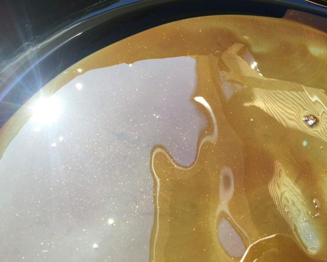

Could have been enough oil to keep it from destroying itself. The fact that it still runs and you don't notice any noises is a great starting point. Put 50-100 miles on it then do an oil/filter change. After draining the oil, look for metal flakes which would point to bearing failure.
If the oil looks like glitter (gold flakes), that's bad news.

You can drain the oil now and look for glitter. Or make some short trips staying relatively close to your house. That way if something goes wrong you're not far away.
