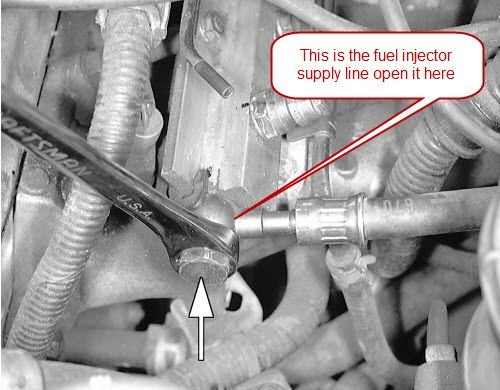

STEP 3. OPEN THE FUEL PIPE CONNECTING THE FUEL INJECTOR AND DRAIN: The easiest way to locate the fuel pipe connecting to the fuel injector is to locate the fuel filter that is near the back wall when you open the engine compartment somewhere near the battery, the picture below will guide you to what I mean. As shown in the 2nd picture below open that bolt make sure you save the washer and bolt that you opened safe, then get a empty milk gallon and insert the pipe that you just opened inside the milk gallon.
Then crank the engine(usually ask a friend to do so) you should see gas oozing out into the milk gallon , once no more gas in coming out into the milk gallon stop the process. This whole step ensures that there is no more diesel left out in the supply line and leaving the spark plugs still open in step 2 ensures that the engine cranks easily without too much load to the battery. Leave the pipe open for now.
NB: If you want you can replace the fuel filter too which other gurus might recommend too, but frankly speaking its not required.
The left image is a reference on Fuel Filter location and how to trace the pipe which connects to the fuel injector supply line.the image to the right is how the other end of the pipe connecting to the filter should look like.
