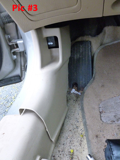

-- Step 2: Remove the Hood Release Lever panel cover See pic #3
We need to remove the plastic door jamb cover to get at the fuel door mechanism. Before we can do that, we need to move two other plastic jamb covers, starting with the one in front of it, near the Hood Release Lever. The easiest way to get it off is to start from the left (outside edge), pull it back and push it to the right, over the door jamb. Then reach inside under the dashboard, grab the back right edge, and pull back toward you a little, then pull it to the right, toward the passenger side. Don't be afraid to wiggle and apply a good deal of force, you won't break it.
