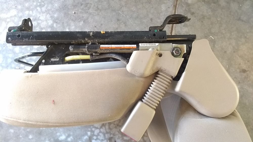

Couple of pics in case anyone ever has to do this. Not a hard job.
2 clips under the seat: yellow tab slides down by hand, grey needs pliers
One 14 mm bolt holding the buckle; four 14 mm bolts holding the seat in (the four are non-interchangeable with the one b/c of length)
