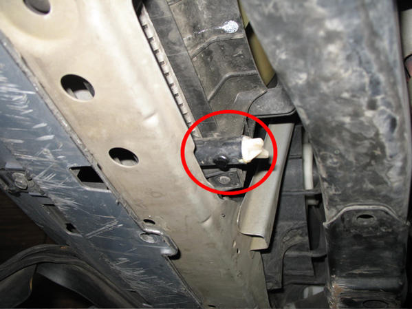

2. Jack up the front of the car. It is important to this step right. Once the car is jacked up it's not coming down until you are done. So make sure it's parked where you will not need to move it half way through.
I used a Harbor Freight 3-ton floor jack (Max lift 18 Inches) placed under the radiator support.

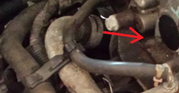

16. Use pliers to slide the water pipe clamp in the direction of the arrow below. This will allow the water pipe to pull out when you remove the water passage of the cylinder head.

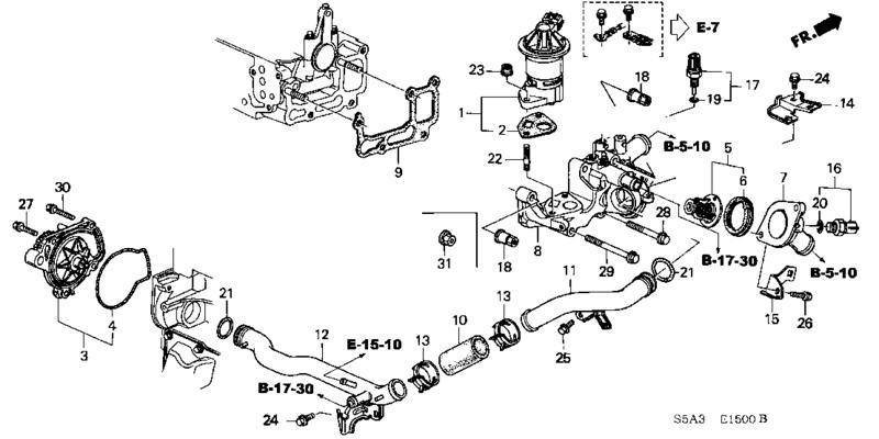

17. The water passage comes off next (part 8 below) Remove the three water passage bolts, two are shown in green below and the third one is in the blue area. Also remove two nuts that go onto studs (shown in red) that protrude from the head.
Keep track of the bolts since they are different lengths. If there is any other connector attached to the water passage remove it now. You should now be able to pull the water passage away from the head. Don't loose the metal gasket. It can be re-used.

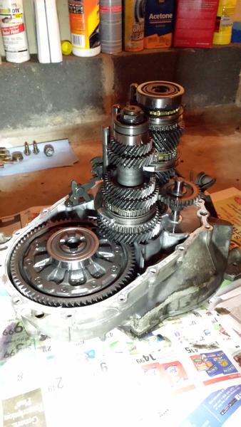

-The mainshaft, counter shaft and shift forks will all pull out in one big assembly. There are two small washers on the main shaft that will most likely fall out when you pull it out. One is flat and the other one has a slightly curved surface. Pay attention to how these fit onto the shaft.
-With the mainshaft removed, the differential will lift out. You can now knock the input shaft bearing out from the clutch side of the transmission. I used a socket extension down the bore and a few good whacks had the bearing out. Pry the ISB seal out as well. I also knocked out and replaced the axle seals from both sides. They looked ok but I figured might as well.
-Start cleaning out the two halves with brake cleaner. I used 2 cans. Don't forget the little magnet. Also clean the sealing surfaces. I used a screwdriver to scrape the old gasket material off and just scrubbed it down with a shop rag and brake cleaner.
-Install a new ISB seal and then the ISB itself. I went to a hardware store with the old ISB and found a section of PVC pipe that was just the right diameter to install the new ISB with. This ensures the bearing goes in straight and true without damage to the ***** or race. Install new axle seals.
-Wrap the splined end of the input shaft where the clutch sits with some tape. If it is greasy, clean it first with some brake cleaner. This will protect the ISB during re installation.
-Reassemble the transmission starting with the differential then the main shaft assembly. Don't forget the main shaft washers. The mainshaft and shift forks all go in as one big assembly.

Question - I just got my transmission apart, and right as the halves separated the main shaft bearing rolled out on the floor. The case fought me a lot trying to split it open, possibly just the stud posts hanging up but now the main bearing doesn't want to slip back on the shaft. It seems to want to bind up going back on, so I didn't force it. Just left it in place partially on the shaft because it didn't want to jump back off again either.. Wondering if it should be replaced, or should I just lube it up and work it back into position, maybe even with a mallet and socket? Honda says it's a three day wait for a new one, don't really have that much time to wait unless really need to.. what do you think?

Got the starter out but can seem to get the water passage out. Am I missing a bolt? I've been color coding all bolts to where they came out of, so if you see some purple, red, yellow, green, ect.....

Okay Got it off, but when I pulled it off a lot of blue coolant went everywhere, and yes, I drainded the radiator and the overflow. After taking off the passage way, I noticed that there was coolant in one of the pipes. So I made a siphon out of some clear tubing and a spray gun, usually found with bug spray (home defense). I ran the tubing all the way inside the pipe with coolant and began siphoning out the rest of the coolant into the same bucket I used to drain the radiator.
Is this okay? When I put my car back together when the transmission is fixed, should I poor fresh Honda coolant into the same pipe I'm siphoning from or is that not necessary?
The water pipe is held in with an o ring, yank the whole pipe back towards the firewall and wiggle till it pops out, it takes a bit of muscle.
And yes that does come off, extended bolt head. It's one of a few that hold the water passage to the head.

Step 22 and 23. For both links, I pulled the cotter pin, which freed up 1 metal and 1 plastic washer, allowing me to lift the round link off of the post. now each link is only connected by the metal bracket which I'm supposed to remove in step 23. Should both of these links be okay dangling from the metal bracket? Once I remove the bolts holding the bracket to the transmission, the links will still be connected to the bracket, should I just move the bracket, connected to the links and shifter cables aside and proceed to the next step?

yep just unbolt that bracket you've circled in red and then move it out of they way, the cables are flexible
