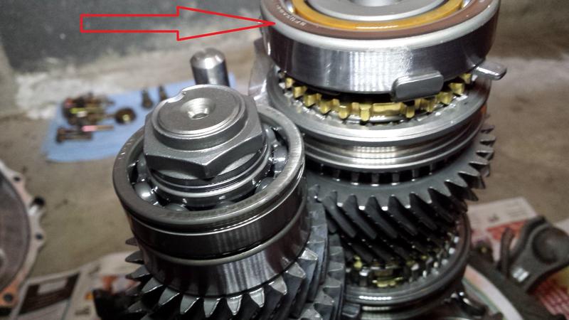

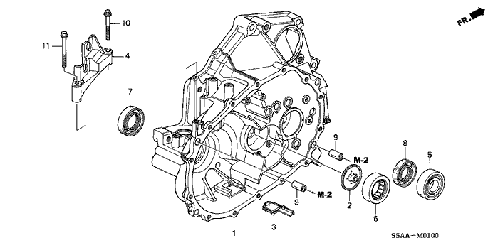

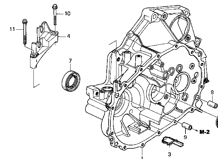

If you are unsure of what the ISB is see the diagram below. The ISB is part #5 and the bearing seal is #8.
The following parts will be needed. The IBS, bearing seal and axle seals are critical parts. I recommend using only genuine Honda dealership parts for these. Honda part numbers are provided:

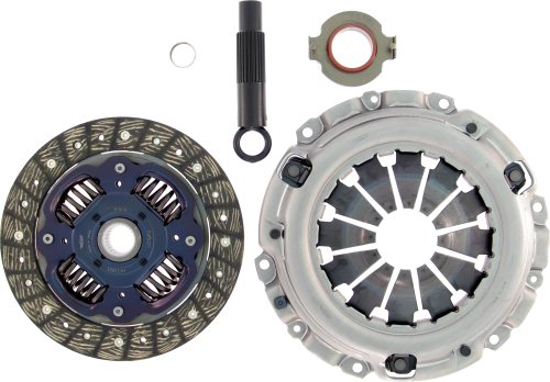

I used an Exedy clutch kit that came with a Pressure Plate, Clutch Disc, Throw-out Bearing, Flywheel Center Bearing and alignment tool. I highly recommend this kit. It is high quality and has a very smooth and soft clutch pedal action.
If you go Exedy, make sure you purchase from an authorized dealer. There are a lot of Exedy fake clone clutch kits selling on Ebay and other sites. These are far inferior quality. Do not use these. There is a list of authorized dealers on Exedy's website. I bought mine from Amazon.com. The actual website and not a re-seller on Amazon.
The Exedy part # for the clutch kit is KHC10.

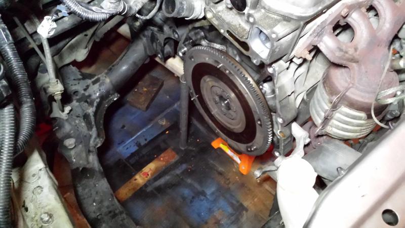

12. The engine needs to be supported next since we'll be removing some more mounts. Place a jack stand under the rear most edge of the oil pan where the oil drain bolt is. Use a block of wood between the jack stand and the oil pan. Never support the engine under the pan without using wood or the oil pan will be damaged.
Locate the jack stand so it's pushed as far as it can go towards the passenger side while supporting the engine under the rear most edge of the pan.
Once you are ready to remove the transmission, the only thing supporting the engine will be the driver side mount, jack stand and partial support from the front mount. The weight of the engine will shift causing it lower and rotate slightly towards the rear of the car. So make sure you have some wood wedged tight under the oil pan and between the jack stand.
I know this is not the most ideal way to support the engine, but I used what I had available. If I had a hoist I would have used it to support the engine, but, using this method, I found the engine to be stable enough to withstand all the jostling and pushing from taking the transmission off. Use caution!

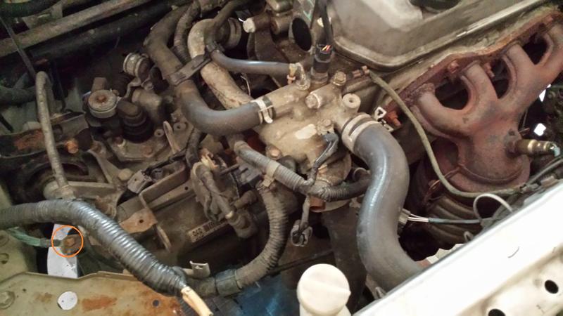

15. Disconnect the wiring harness shown by the green line below. Move it out of the way. Unplug the coolant sensor (yellow circle), ground strap (red circle), and remove the water hoses in blue circles.

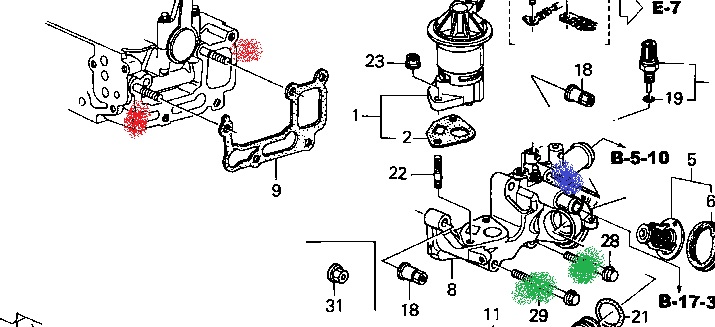

16. Use pliers to slide the water pipe clamp in the direction of the arrow below. This will allow the water pipe to pull out when you remove the water passage of the cylinder head.
17. The water passage comes off next (part 8 below) Remove the three water passage bolts, two are shown in green below and the third one is in the blue area. Also remove two nuts that go onto studs (shown in red) that protrude from the head.
Keep track of the bolts since they are different lengths. If there is any other connector attached to the water passage remove it now. You should now be able to pull the water passage away from the head. Don't loose the metal gasket. It can be re-used.

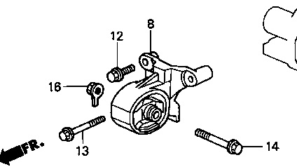

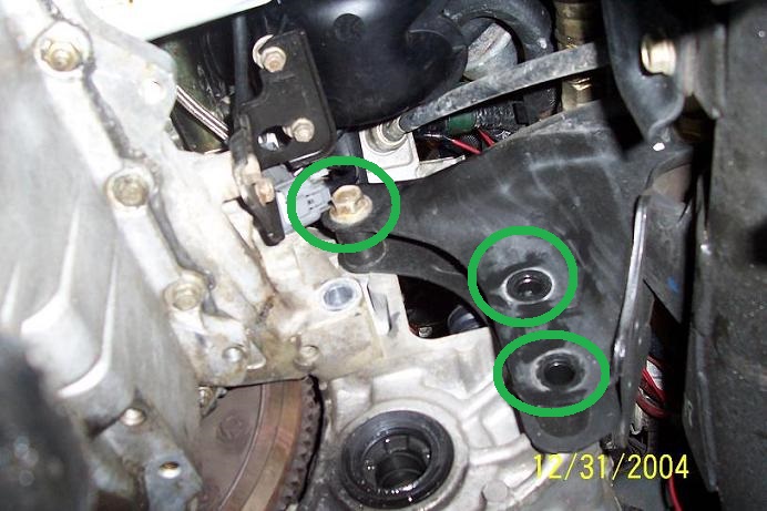

18. Remove the transmission mount next. Remove the bolts that attach it to the transmission and then remove the bolts that attach the mount to the frame. Pull the entire mount out of the car.

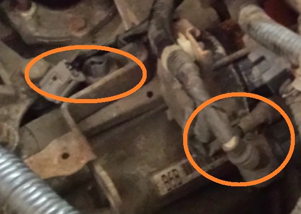

19. Remove the electrical connectors from the starter motor and the reverse sensor. See below. One of the starter motor connectors is held on with a nut. Make sure not to over tighten this nut when hooking the starter back up or the stud will strip and you'll have to buy a new starter. Move the starter/reverse sensor harness out of the way.

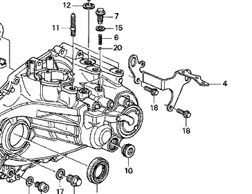

23. Remove the bracket that secures the shift linkages to the transmission (Part 4 below). There are either two or three bolts. You will need an extension. Also disconnect the electrical sensor behind the shift linkage bracket. This is the speedometer connector.
You should now be able to grab the shift cables and bend them back and away from the transmission.
24. Un-bolt the two clutch slave cylinder bolts. Pull the slave cylinder away from the transmission. Pay particular attention to how the rubber boot secures to the transmission. Don't lose the metal slave cylinder push rod. Follow the clutch line all the way to the fire wall and unbolt it from any brackets. There is a bracket near the fire wall that will need to be removed from the car to make way for the transmission.
Once the slave cylinder line is un-bolted you should be able to carefully move the entire slave out of the way. The line bends a little. be careful not to break it.
25. Remove the upper bolt that secures this bracket (part 4) to the transmission. Unscrew the lower bolt a little but don't remove it. The bracket will now pivot around the bolt and make a convenient hand hold for lifting the transmission out of the car.

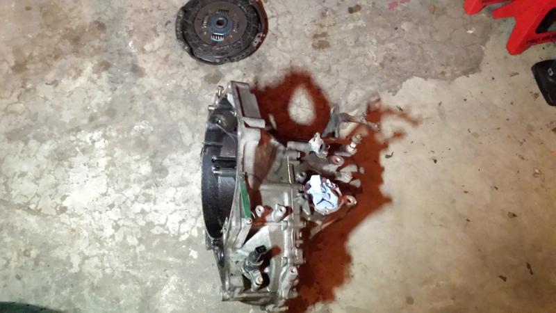

27. The pressure plate and clutch disc have to come off before the transmission can be removed. You will have enough clearance to remove them with the transmission pulled to the side.
28. The transmission is now ready to be pulled out. Put a jack under it so you have some extra support to set it down. Wiggle it from side to side and it should slide out. You can now slide it back towards the wheel and set it down on the sub-frame and the jack.
The pressure plate bolts come out easy if you jam the flywheel with a crow bar to keep it from turning. take it off and note the orientation of the clutch disc. Do not get this wrong during re-assembly. It will most likely fall off once the pressure plate is out.
29. Time to lift the beast out! Now you can decide how strong you are. Mine weighed 72 lbs (33 Kg) when I weighed it after pulling it out. It's do able by your self but much easier if you have a helper. Make sure you have someplace solid to set the transmission once it is out.
30. Now that the transmission is out, remove the flywheel bolts, pull the flywheel off and take it to a machine shop for re-surfacing.

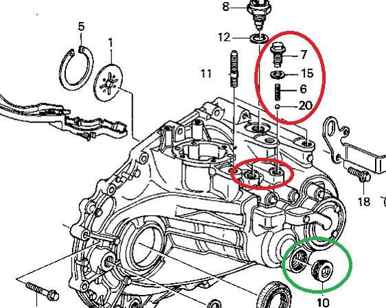

-There are two bolts on the top that need to come out. (Red circles see below) With the bolts out, a spring and a check ball comes out from each bolt hole. Use a magnetic screwdriver to pull the check ***** out. Note how this stuff goes back together. Check ball first, then spring, then bolt.
-Remove this plug using just the driver on 3/8 socket wrench (Green circle above). The snap-ring inside needs to be spread apart.

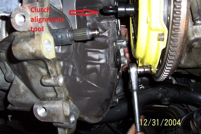

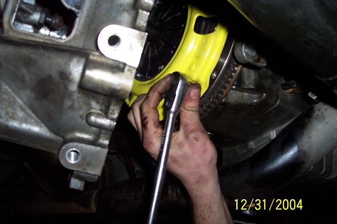

34. Bolt the pressure plate to the flywheel with the clutch disc sandwiched in between. Secure the bolts finger tight only and then use a clutch alignment tool to center the clutch disc before torquing the pressure plate bolts in a criss-cross pattern.
Turn each bolt in a few turns at a time before moving over to a different bolts. In this manner torque all the pressure plate bolts down in several steps.

8. While you are still under there, remove the three bolts that attach the rear engine mount to the transmission. The transmission and engine will shift a little but won't fall on your face because the other 3 mounts are still holding it up.
31. To replace the input shaft bearing, the transmission will have to be pulled apart. I followed this excellent guide on you tube:

Question - I just got my transmission apart, and right as the halves separated the main shaft bearing rolled out on the floor. The case fought me a lot trying to split it open, possibly just the stud posts hanging up but now the main bearing doesn't want to slip back on the shaft. It seems to want to bind up going back on, so I didn't force it. Just left it in place partially on the shaft because it didn't want to jump back off again either.. Wondering if it should be replaced, or should I just lube it up and work it back into position, maybe even with a mallet and socket? Honda says it's a three day wait for a new one, don't really have that much time to wait unless really need to.. what do you think?

stuck at step 17, when looking at the diagram, I have no idea what Im looking at. I disconnected the hoses and cables in the previous step, (great pictures, nicely colored) then step 17 might as well be looking a plans for the space shuttle... my car is in pieces... ugh
Posts: 9,636
Likes: 1,283
From: Barrie, ON Canada
Rep Power: 222
Re: DIY: Input Shaft Bearing
I just supported the engine with a jack, I know there's usually two little lifting brackets by the valve cover that you attach the chain to for lifting the engine out.
For the water passage, on my car there was a couple nuts and a couple bolts holding it on, you'll need some extensions for a couple of them. Drain the coolant first!
You may find it easier with the starter removed.

Got the starter out but can seem to get the water passage out. Am I missing a bolt? I've been color coding all bolts to where they came out of, so if you see some purple, red, yellow, green, ect.....
Okay Got it off, but when I pulled it off a lot of blue coolant went everywhere, and yes, I drainded the radiator and the overflow. After taking off the passage way, I noticed that there was coolant in one of the pipes. So I made a siphon out of some clear tubing and a spray gun, usually found with bug spray (home defense). I ran the tubing all the way inside the pipe with coolant and began siphoning out the rest of the coolant into the same bucket I used to drain the radiator.

Step 22 and 23. For both links, I pulled the cotter pin, which freed up 1 metal and 1 plastic washer, allowing me to lift the round link off of the post. now each link is only connected by the metal bracket which I'm supposed to remove in step 23. Should both of these links be okay dangling from the metal bracket? Once I remove the bolts holding the bracket to the transmission, the links will still be connected to the bracket, should I just move the bracket, connected to the links and shifter cables aside and proceed to the next step?
Posts: 9,636
Likes: 1,283
Rep Power: 222
yep just unbolt that bracket you've circled in red and then move it out of they way, the cables are flexible

the input shaft and 2 hollow alignment pins will be holding it to the block, pry carefully to separate it. tapping with a rubber mallet may help too. the subframe will be in the way of the transmission dropping to the ground, remove the pressure plate, clutch and flywheel and then you can finangle the transmission out.
