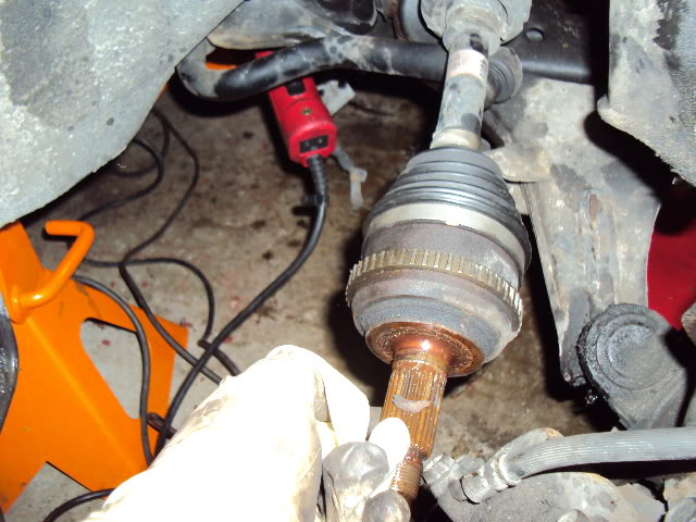

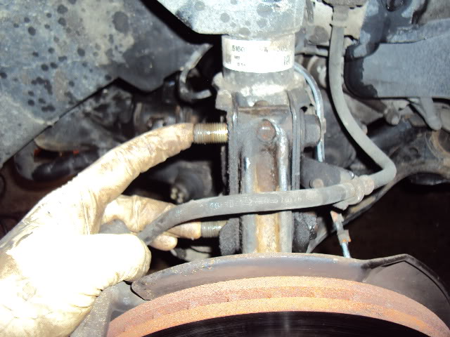

Hi im going to show you how to remove both axles from a auto 01 civic ex or manaul. the manual has some less steps
first lift car on jacks and remove wheels
then you see the spring and strut
1. remove the 2 bolts

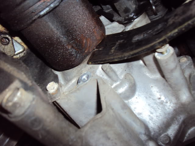

then go under car
you see this
remove all the shift linkage cables and covers

hammer the tabs out if the way and remove the screw
then get a crow bar and press out till the axle pops out
BECAREFUL DONT PULL ON AXLE IF NOT POPED OUT
driver side done

remove bolts

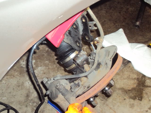

remove brake line holder and abs knock wire holder or it will tear

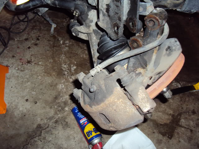

tap out like other side

with crowbar push out and tada
you done
Please be informed that an alignment is warranted after removing the knuckle

Few things: I'd show how to get the axle nut off first (use a flathead to take take the notch out, then use ) and then do the two bolts holding the brake assemble on.
