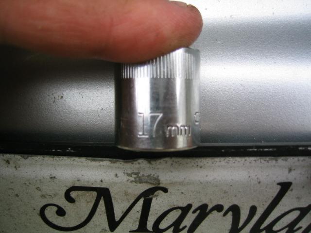

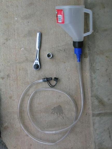

Tools Needed: 3/8inch wrench, 17MM socket, funnel (from Homedepot), 4 Jack stands, and a jack.
Step 1: Once the front of your car is up on the two jack stands, get out your funnel, wrench, and 17mm socket.

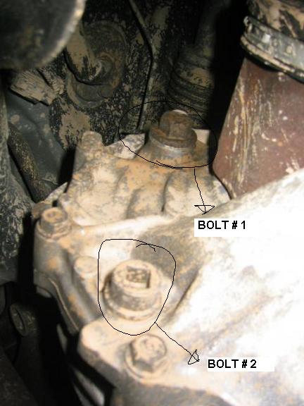

Step 2: Look underneath the front of your car. You will see something similar to the picture below(maybe a little cleaner ):
Step 3: Place the wrench (without any socket attachments) into bolt #2. As you can see, bolt #2 has a hole in it that fits your wrench perfectly. Unscrew the bolt by turning couter-clockwise. Have a small bucket to catch all the manual transmission fluid about to pour out of where socket #2 is located. Once all the fluid has been drained tighten bolt #2 back on to the transmission.

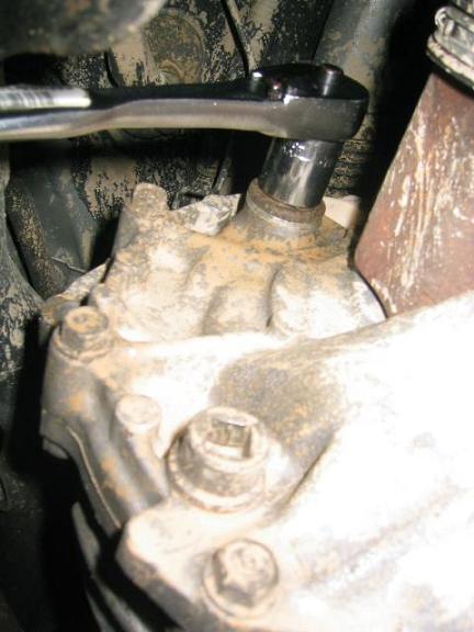

Step 4: Using your wrench with a 17MM attachment as seen below,

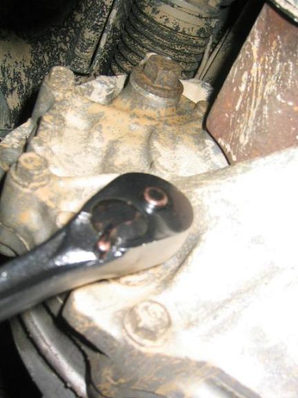

Unscrew Bolt #1 (as seen below) by turning counter-clockwise.

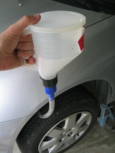

Step 5: Have a person stand next to your car and hold the funnel as seen below.
Place the end of the funnel into the hole created by removing bolt #1. Tell the person to put the manual transmission fluid into the funnel. Once 1 quart is done tell the person to start on the second but pouring very slowly. Once about 60% of the second quart has been used, the hole from bolt #1 might start to overflow.

Only thing I would do is undo the fill plug before the drain plug. That way, you can make sure you can put in the fluid. Id recommend redline mtl if you guys like to mash on your trannys a lot like me!!!!!
