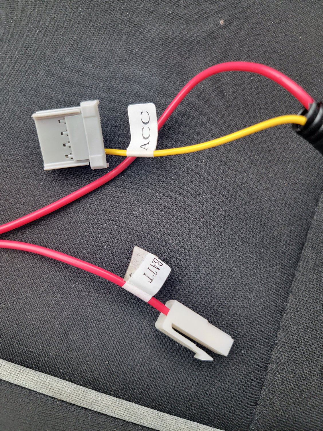

it could not be sooo difficult to install them. this DIY is awesome but i got some differences in the wires.
i know how to remove the front bumper (i´ve replaced the horn recently) and how to guide the wires through the engine bay thanks to this DIY
here i post some pics in 2 major groups, as they come in the box
here i got the plugs to the fogs on the left.
and then the first detail pic is one red cable with a metal hook in the end and a yellow cable with a metal plug in the end
then the relay and a little fuse box (on the 2nd detail pic)
they all came already pluged as i show in the pic in a large group
SO: where should I connect the red and the yellow cable?
where should i put the little fuse box? and the relay?
this is the key to put the fogs ON, already pluged with the green plug and in the other end 3 connections
the black one with the hook, the yellow one with the metal plug and the brown plug that has a paper sticked on it that says "ignition"
SO: where should I connect this 3 connections?
and then theres a solitary red wire with two metal plugs in the ends
i got the intention to install all by myself and not spend more money. i feel i could make the bumper cuts, all until i came in front of the final connections
also i want this fogs only to work if i switch ON the position lights (and of course low beam lights)
thanks all in advance!!!!!!!

Hi, I'm newbie as well in the middle of doing my foglight installation. I'm hoping to install the switch harness sometime this week so when I find the 1-PIN Connector under the dash, I'll post a picture to help.
Now, I too also need help. Here is a picture of my switch harness:
From TOP to BOTTOM, LEFT to RIGHT:
1. Fuse
2. Relay
3. 1-Pin Connector
4. Plug to switch
5. Ground wire
6. Wire from switch (plug)
7. Wire from fuse
Okay, so from this thread, it seems like the red wire (#6) from the plug needs to be spliced into a 12V line to power the switch.
My question is: where is the red/white wire (#7) from the fuse suppose to be spliced into? Is it the battery?
In case it helps, I drive a 2010 Honda Civic EX

both #6 and #7 need 12v. #6 is power to light up the switch and #7 is the power for the fogs themselves (hence the fuse). so id splice #6 into your cig lighter or parking lights. and #7 into a good 12v source. and not one with tiny wire either unless you want melted wires... if the newer civics use the same type of fuse box under the dash as older models id crimp a spade terminal on the end if the fuse wire and connect it to one of the aux 12v's w/ ign on your fuse box.
the colored plugs are the aux 12v's. if your fuse box looks like this then white is constant orange is ign and red is on im pretty sure.
Hi Pwnsauce,
Thanks for the information. I took a look under the dash and my head almost exploded so I'm hoping you can guide me a little further. Here is what my fuse box looks like:
#6 caught my attention has it is marked for the foglights but here is is marked as a 20A fuse but the one that was provided with my switch harness is 15A. Any ideas/help would be greatly appreciated. Thanks!

im pretty sure thats what both of my ek fog harness's use is a 15a.
if you want probably the easiest install youll need to go get 2 of these
http://www.oreillyauto.com/site/c/de...ord=add+a+fuse
any autoparts store has them and maybe even walmart or something but there stupid simple you just unplug your 20A foglight fuse plug the add a fuse in and put your 20a fuse back in along with your 15 and connect the wire from the harness to the lead off the fuse. the other one youll have to use your headlight fuse or anything that gets power when you turn them on (dash lights, parking lights)

I'm trying to hook up my cheap ebay fog lights for my 01 civic coupe.
My wiring harness came in 2 parts, behind the bumper/under the hood is a U shaped harness connecting to both lights that I installed in the bumper.
The second part of the harness pictured below, this harness has a BATT wire, an ACC wire it also has a relay, fuse and a rocker switch already connected. And of course an extension wire to go through the firewall.
The exterior part of the harness is hooked up, I plugged the ACC and BATT plugs in to my fuse box under the dash and connected both ends of the extension wire but I'm not getting power to the lights or to the switch. The switch looks like it should illuminate.
Im not sure what I'm missing but any help would be greatly appreciated!
Harness for interior part on installation. Switch and relay circled
Close up of batt and acc plugs on harness
Acc and batt plugs in the fuse box under the dash.

Where is your ground connected? Is it bare metal?
