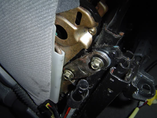

Start by finding one of the height adjustment brackets near the front of the seat. start on the inner console side facing the passenger seat. it has two large gold nuts holding it down. remove the nuts with a socket wrench and you will have this.

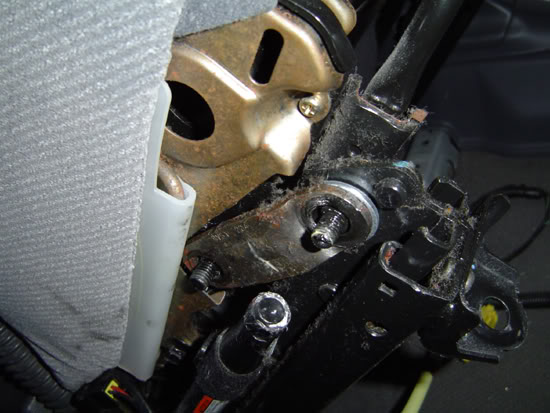

next remove the two washers behind the nuts that have the square shape hole in them. then with a large flathead screwdriver, pry out the shiny bracket. be careful not to damage the seatbelt explosive stick near it! under the bracket is another weak bushing type of piece. take that out as well. these are all the things you should have from one side. two nuts, two washers, two bushings, one bracket. the studs on the seat should be empty and have nothing else on them. now, keep the two gold nuts and bracket and throw away everything else. here is a pic showing the parts you removed.

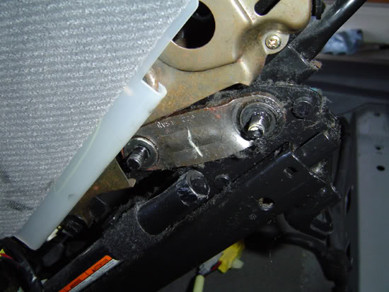

be sure to keep the bracket and two gold nuts! you will need them. now this is what the seat should look like with all that removed.
now you need to go hunt for 4 round metal washers (two per side). it is very important to get the sizing right. it should be about the same thickness as the bracket. the center hole needs to be large enough to fully clear the stud and surrounding metal so that it touches the very back of the seat. if its too thick, the bracket will not mount flush or tighten properly. too thin and the chair will still be loose. you want to simply eliminate the empty space in the back and "push" the bracket up so that it lines up with the stud threads. that way when you tighten the nut, it will make full contact with the bracket and the back of the chair. essentially forming a tight and secure mount between bracket and seat. here is what it looks like with just the new washers put on. notice they sit fully back and clear the middle stud and surrounding metal. the hole can be a bit loose as you can see, and the washer will hang down. this is not a problem so long as you have enough contact for a strong connection. one washer is gold and one is silver because i just found these lying around the garage.

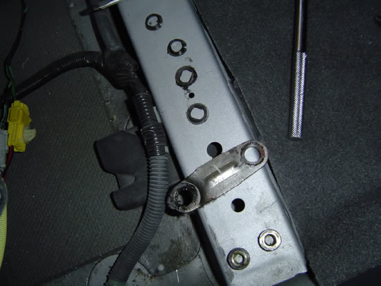

now loosely fit the bracket back on over the washers. ensure that the top of the bracket is lined up with the bottom of the stud threads.

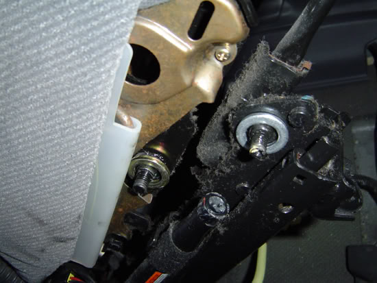

put the gold nuts back on and tighten them hard. they are big, just have at it and go at least 40-50 ft/lbs so they will not go anywhere. its possible over time the bolts can come loose from multiple sitting events. i was in a hurry, but what i shouldve done was put some jb weld between the washers and some red threadlocker (permanent metal bonding) on the nut and stud threads. then there is really no chance of it ever coming loose. but i was in a hurry and at least next time i know what to do if it ever gets loose.
here it is with the new washers in place along with the bracket and tightened gold nuts.

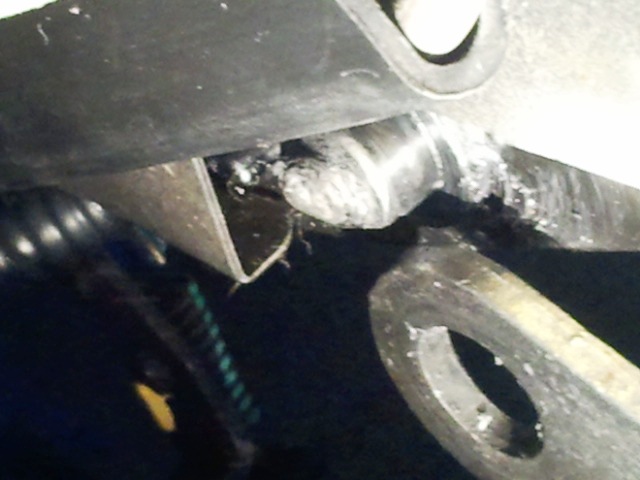

I HAVE READ THROUGH THE GREAT GEARBOX EXPLANATION AND FIX. IT APPEARS THAT MY ISSUE IS THAT THE BOLT ON MY SEAT DOES NOT STICK OUT FAR ENOUGH TO PUT A NUT ON THE END OF IT LIKE IN THE PICTURES. iT APPEARS THAT THE END IS BROKEN OFF, ALTHOUGH I DON'T KNOW HOW THAT CAN BE SINCE THE SEAT HAS NEVER BEEN OUT BEFORE. IS THIS HOW IT IS FOR OTHERS? ANY OTHER SUGGESTIONS?
