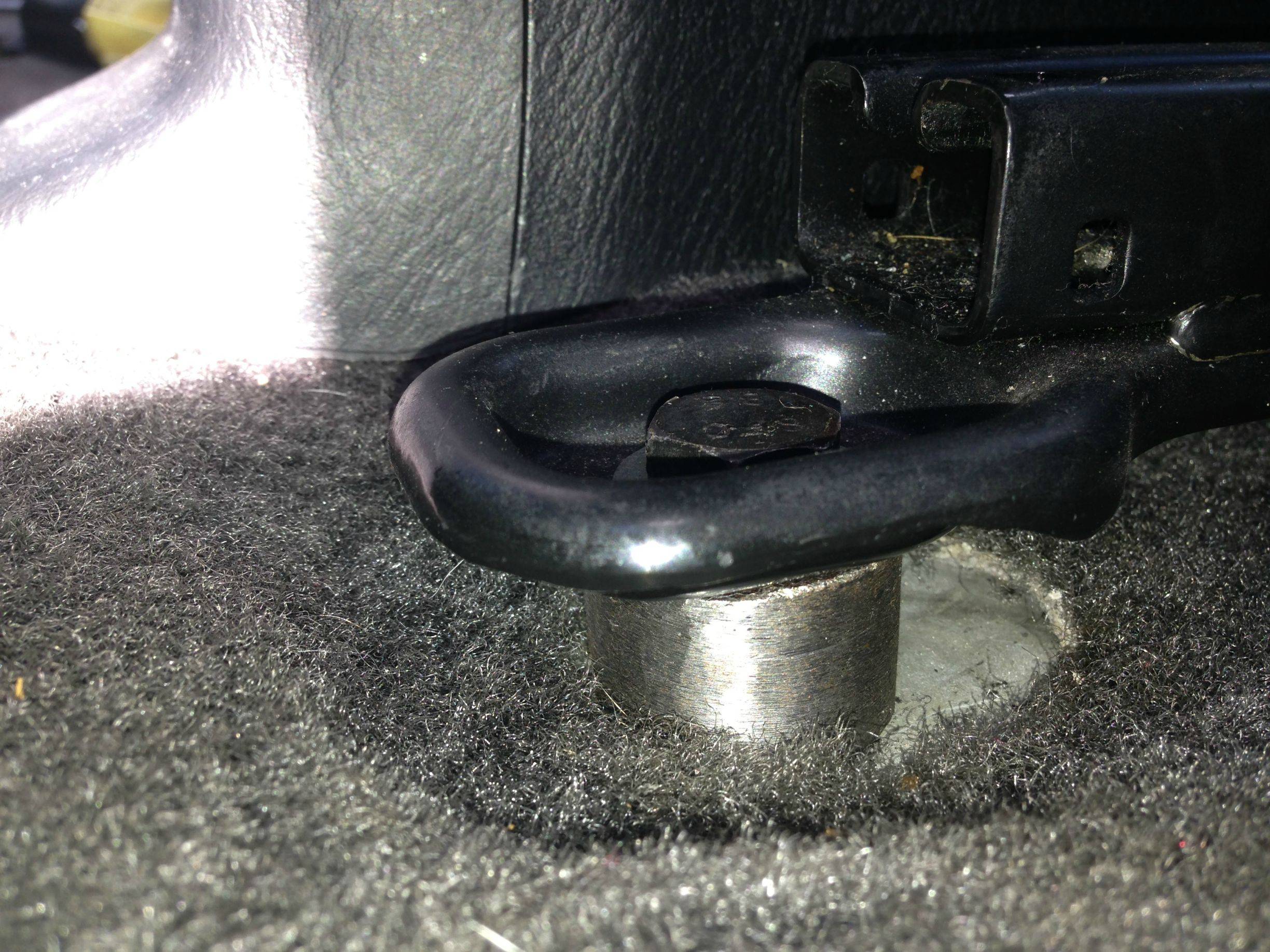

On the passenger seat facing the front;
The back left requires a lift of 1.25in on a piece of steel to rest easy. Use the 40mm x 1.25mm here to reach the mount point.

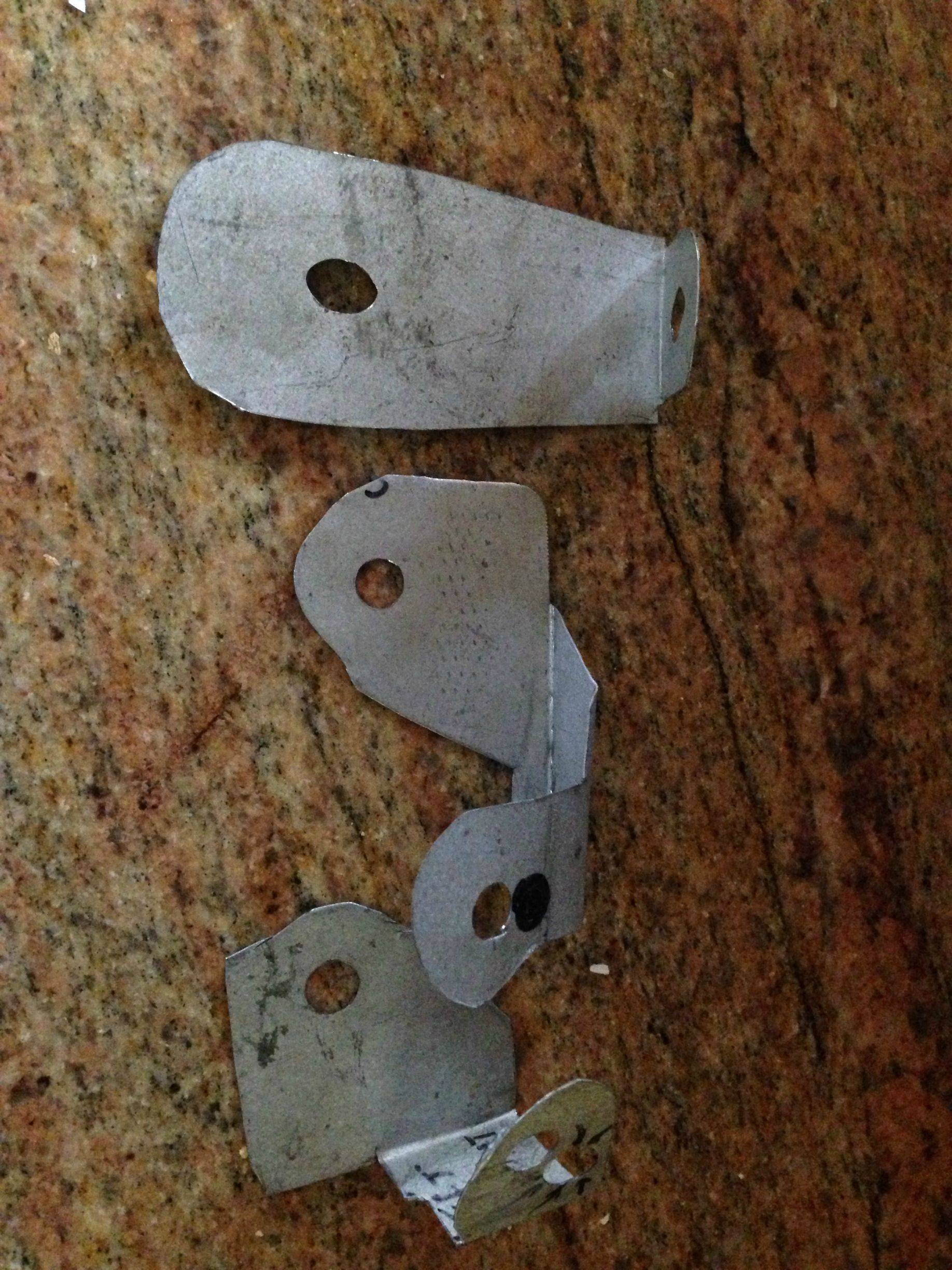

The rest of the mount points require brackets made of your steel.
I recommend getting your measurements and cutting out makeshift brackets out of aluminum.

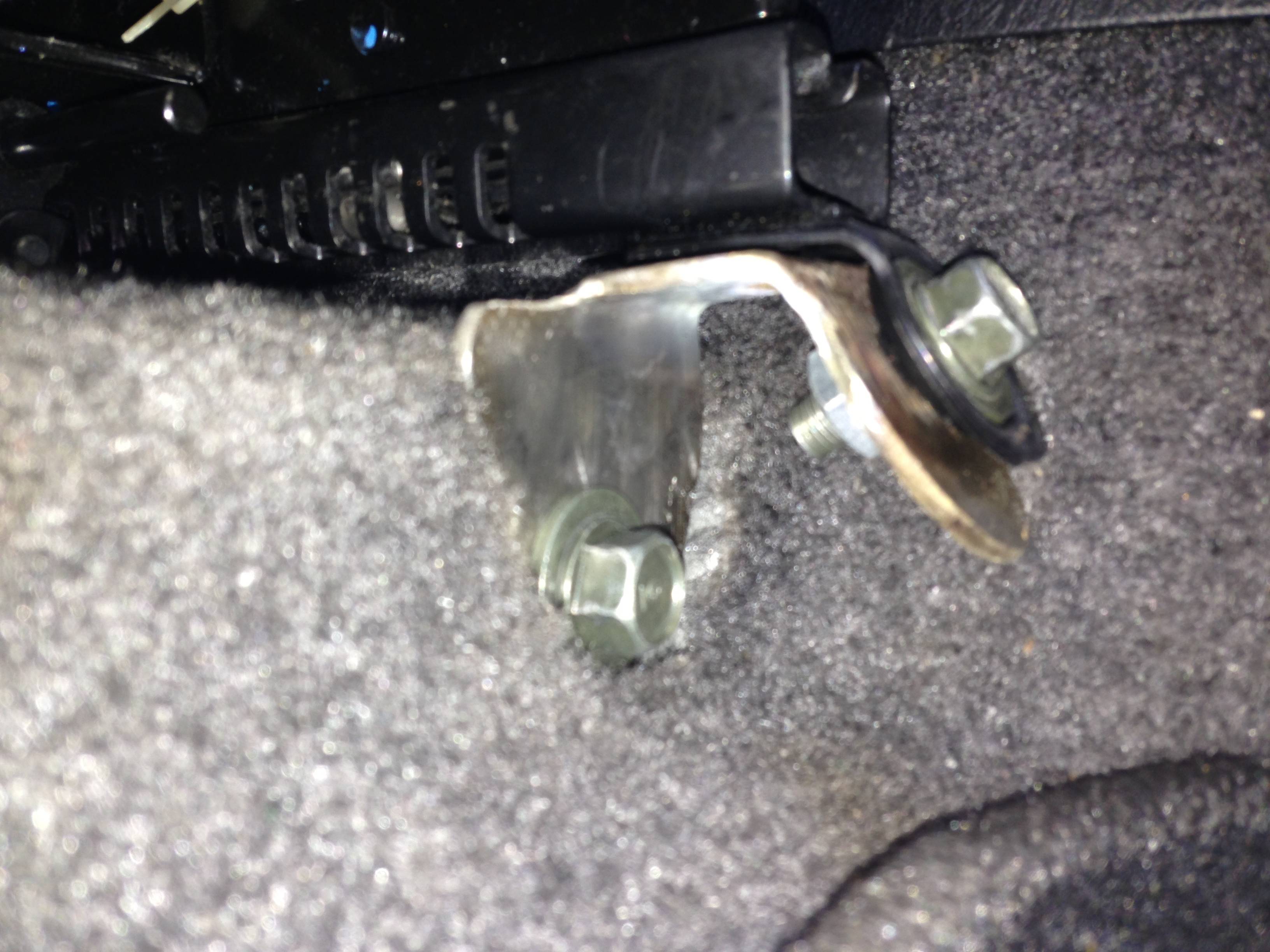

All of the brackets bolt into the car first, use the OEM screws where you want and use one of the 30mm x 1.25mm for which ever hole you have left over. Make sure you put washers on both sides.
The front left bracket gets close too the center console so make sure you leave enough free space so you have enough clearance.

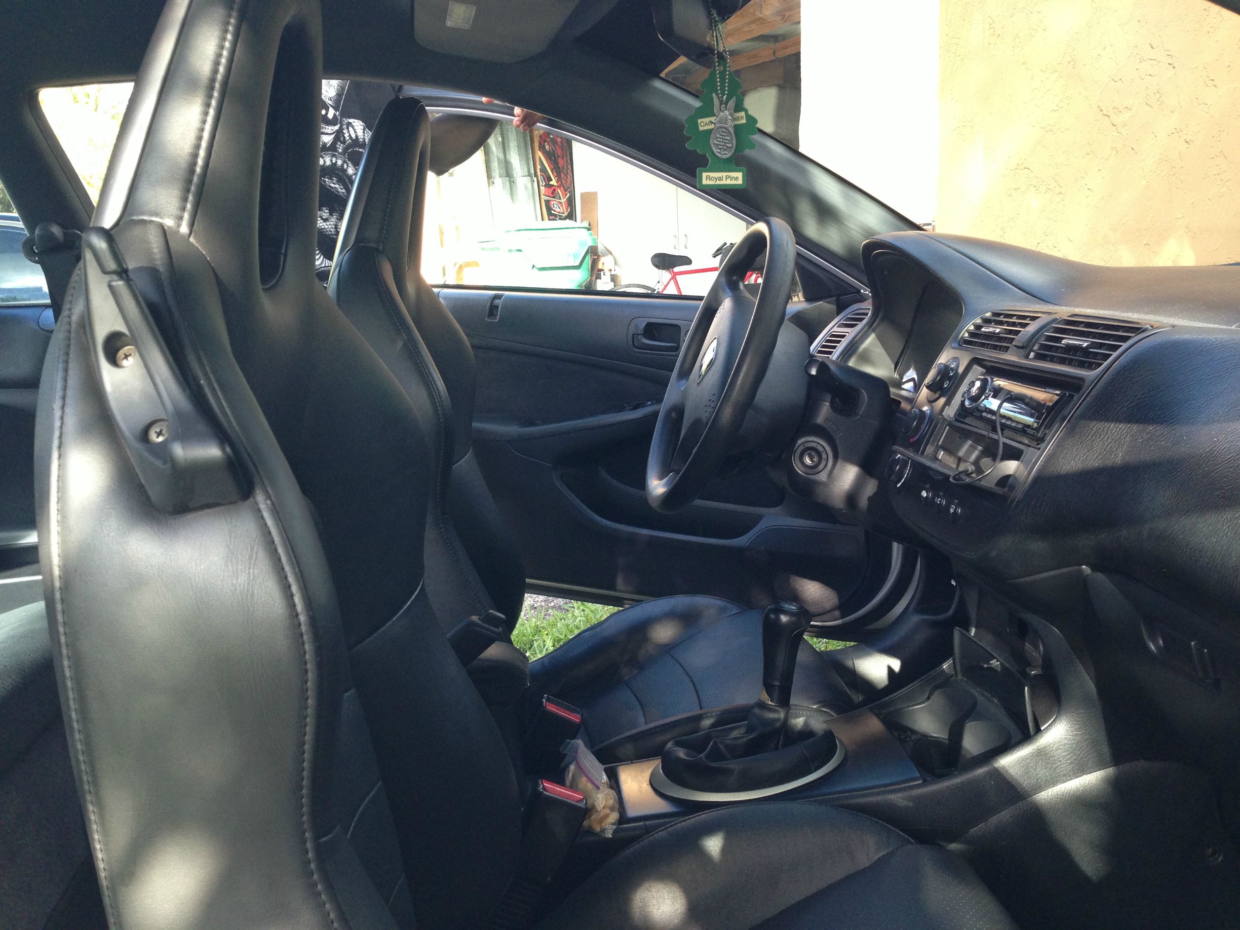

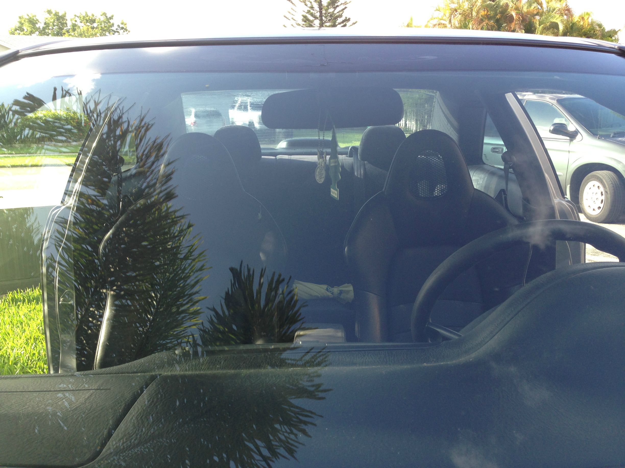

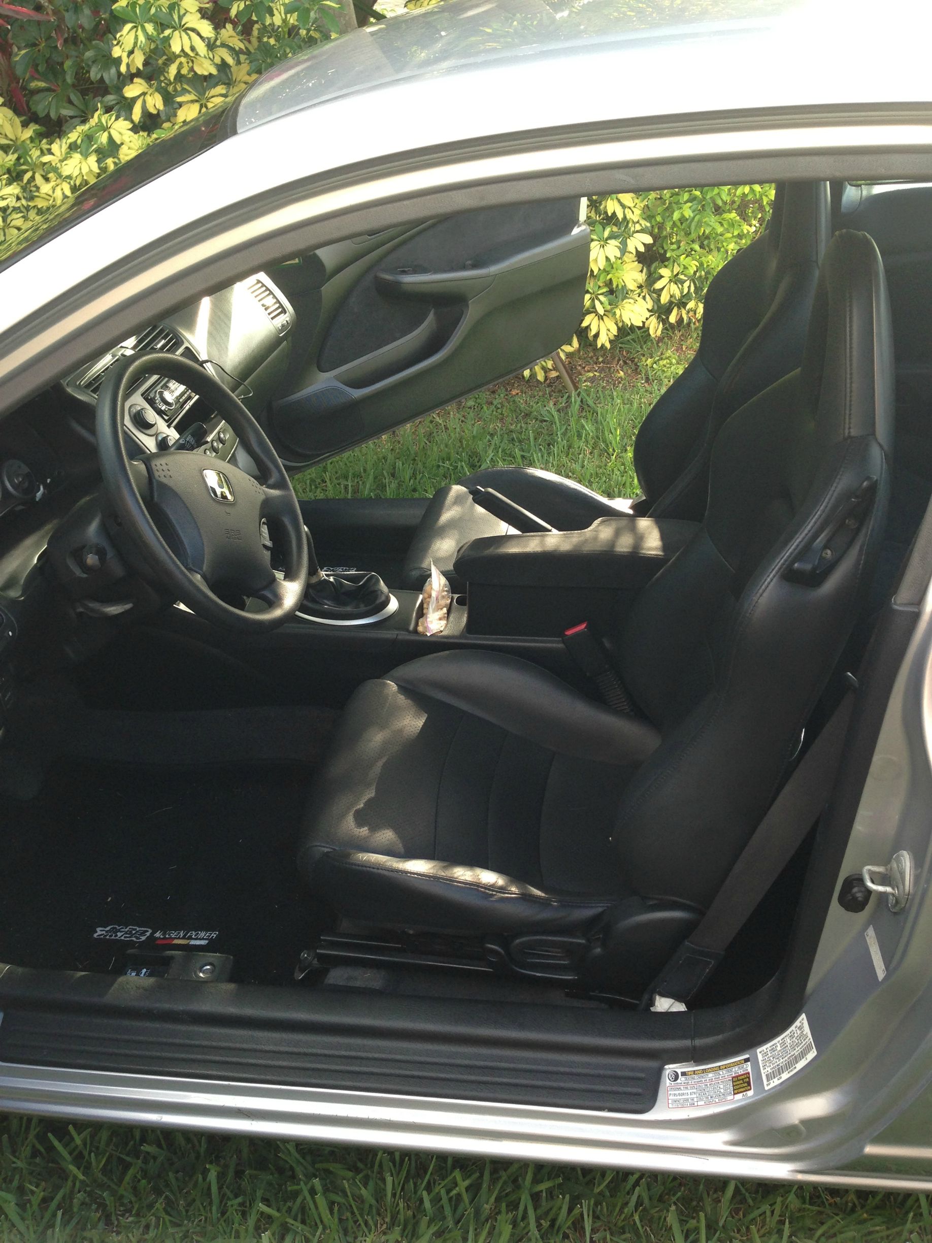

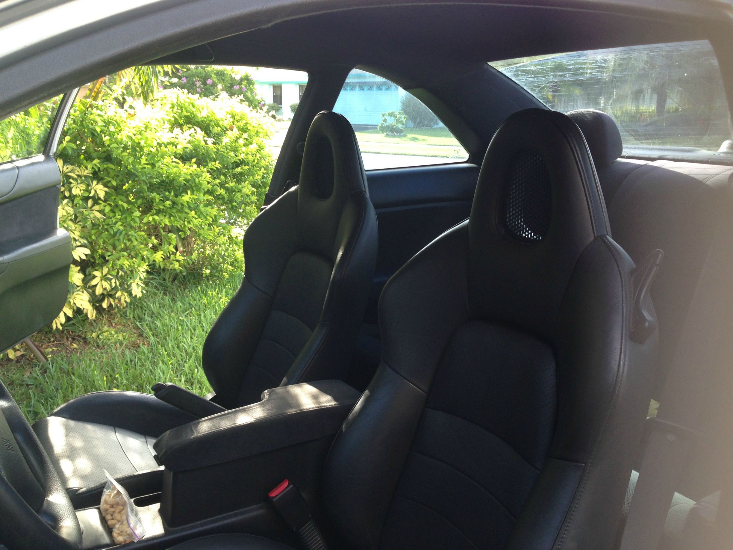

At the end, you should finally have s2000 seats in your em2.

Lol, the aluminum brackets where just for practice to get the right measurements. The actual brackets you see in the picture is high SAE grade steel.
And the zip tie is to keep the srs pretensioner on the seat belt from moving up and down. The actual seat belt are attached in the same way as the EM2 one.

Quite nifty, but I don't know how I feel about the brackets as they are. I know it's SAE grade steel and all, but how they hold up with dynamic stresses of car vibrations and (assuming) 150+lbs weight after a while.
I just feel like they'd be safer with some of the scrap metal welded perpendicular to how the brackets are bent. Thinking about the metal microscopically, you've introduced a "pre-existing flaw" by bending the metal, making it more prone to breakage. But maybe I'm just thinking too technically about it. (Referencing your aluminum template picture) I'm not so much worried about the first bracket, because it seems to be resting on the floor, but the other two which are more "load bearing" are the ones I'd add additional support to.
Thank you for your comment!
You mentioned some very real issues. For example I was thinking about putting a cross member between the front two brackets, but since the seats dip in the rear and 50-60% of the load is shifted back and the rest is divided between the two front ones.
What I do plan on doing is making the front brackets complete, without a break. That way the load is more evenly distributed. All I would have to do is weld the ends of the brackets together.
However, for the moment, I feel that the brackets are safe enough to drive in. I had my dad check them out for me before I drove in them. He works for the DOT, and knows a bit about car safety and the forces that act upon it in the event of an crash for example.
