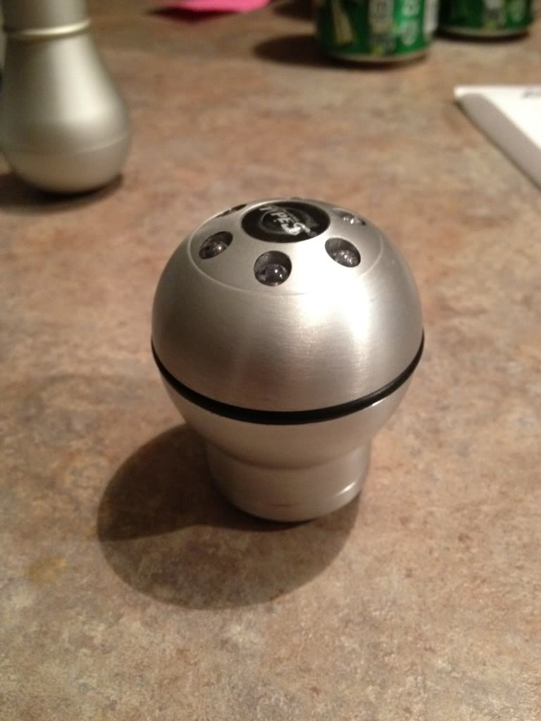

To start it off, heres my new shift ****. Pretty standard.

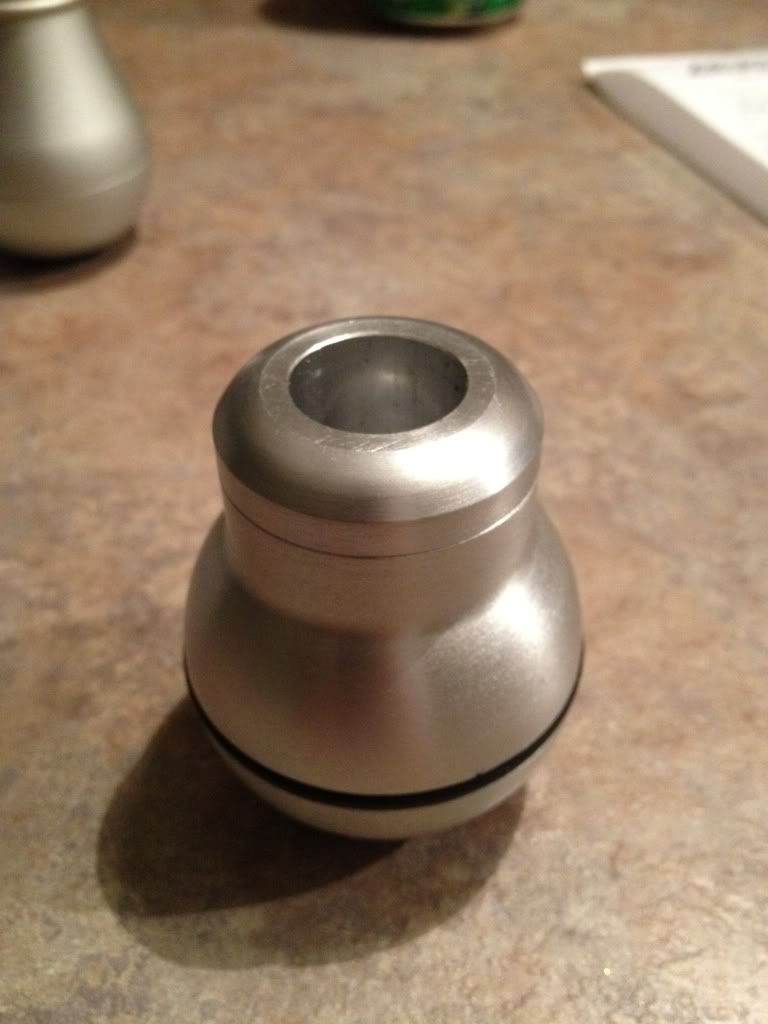

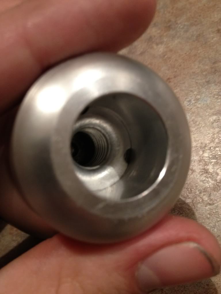

Turn it over and screw off the top

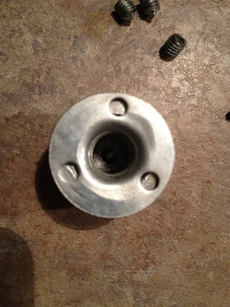

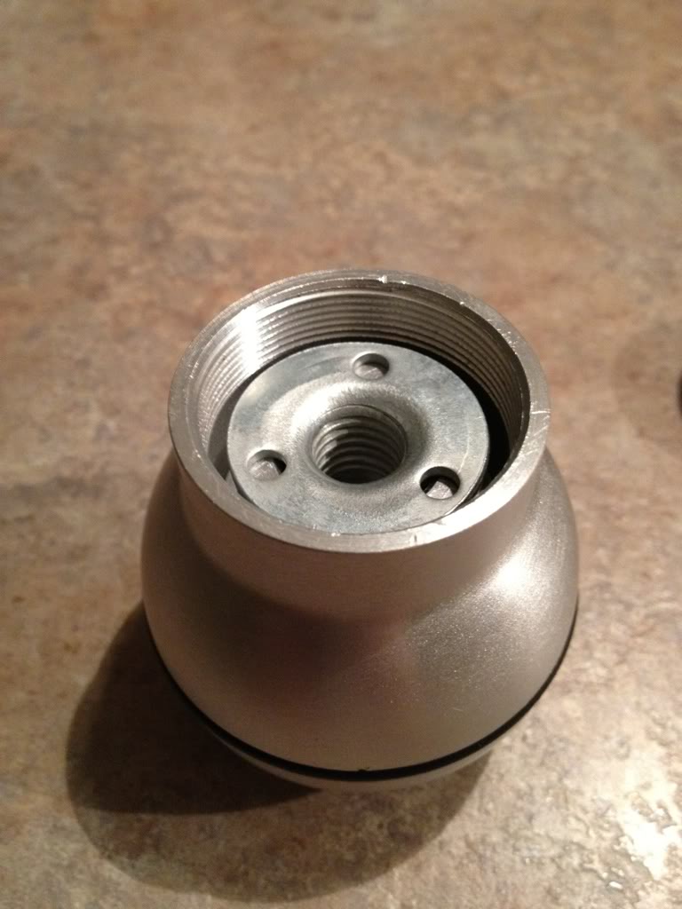

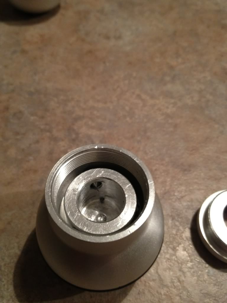

Take that inside part (lets call it the thread house) and screw it off. I had to use a small needle nose. worked fine.

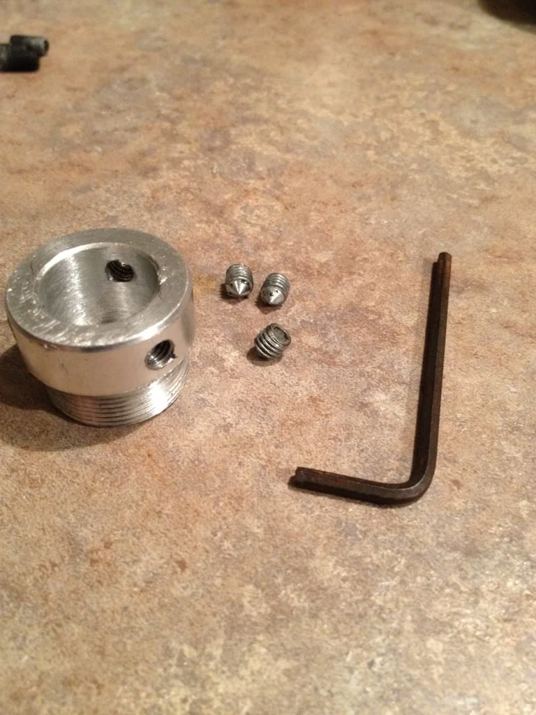

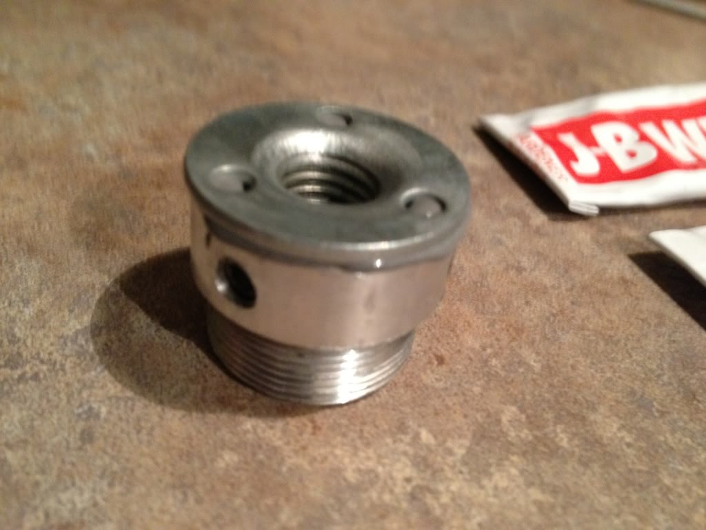

Now that thread house needs some modification. Start by removing those hex keys with your trusty allen wrench.

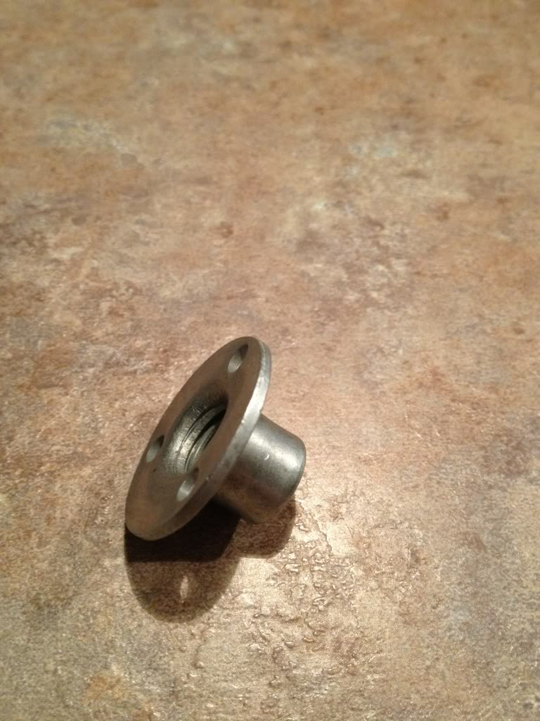

I bought one of these from my local hardware store. No idea what its called, but its a M8-1.50 thread. The deeper it is, the more grip it will have during a shift and in general. This is the deepest the hardware store had.

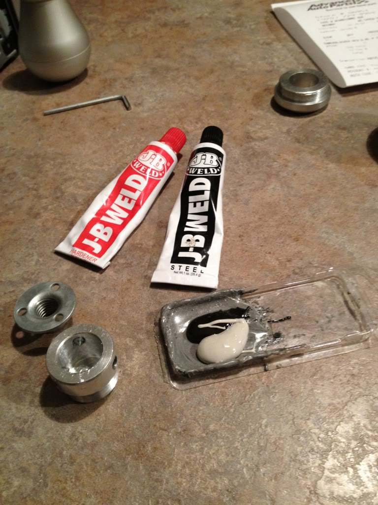

This is my favorite stuff ever. If you dont have any, buy some.

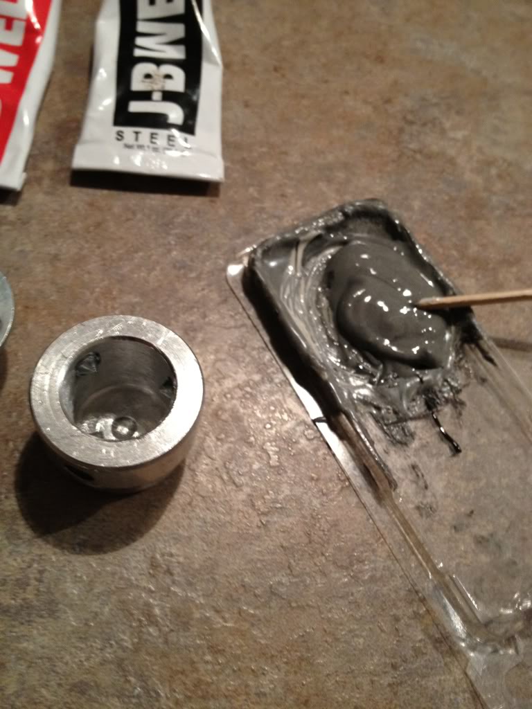

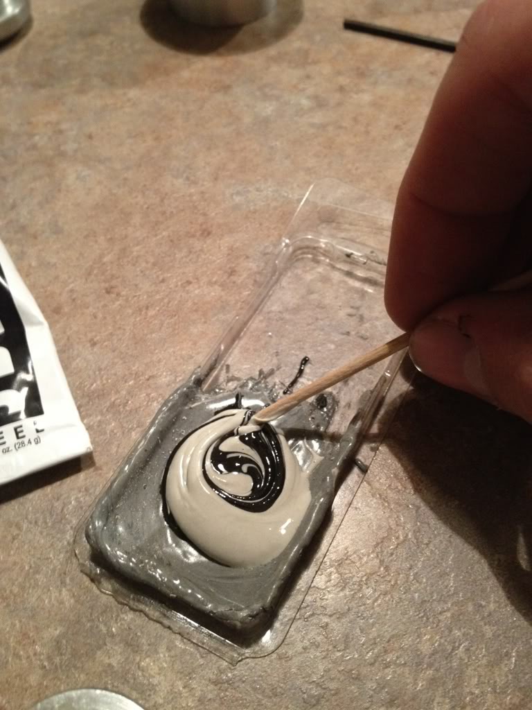

Mix up your JB Weld 1:1 ratio with whatever you have around. In my case, a toothpick :P
After youre done mixing it should look something like this

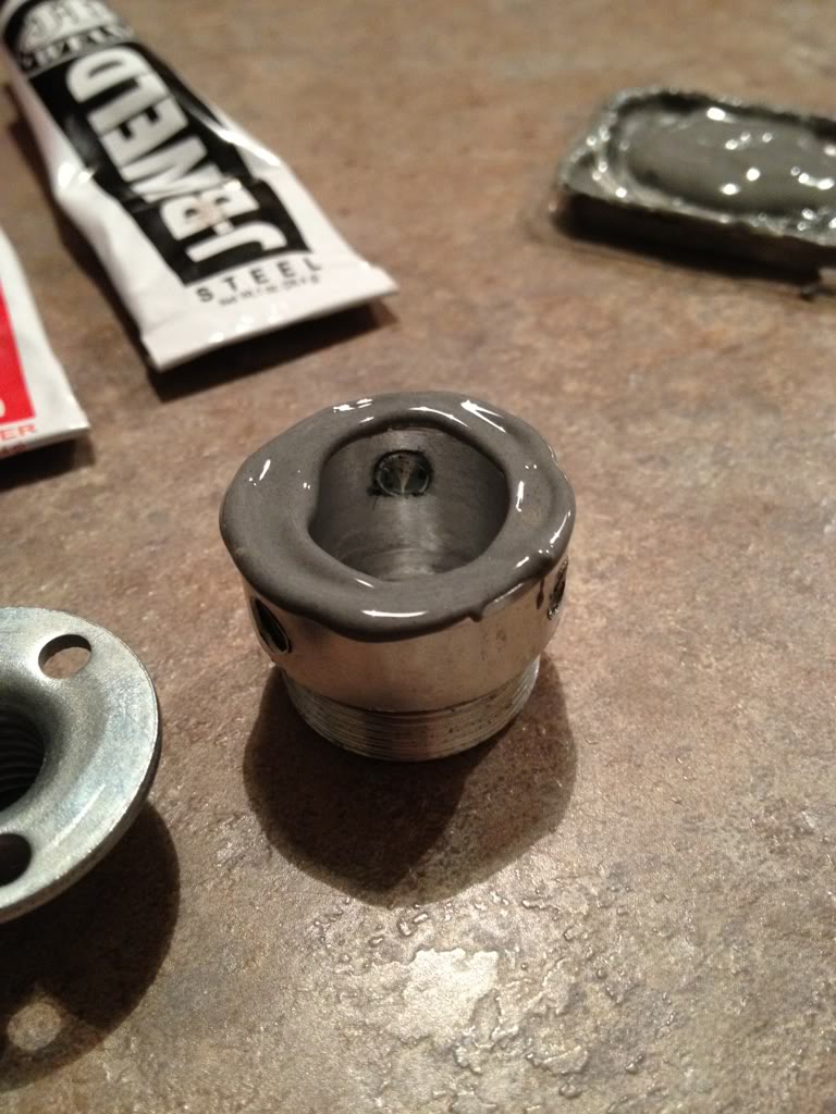

Apply the JB Weld mix on top of the thread house and use a liberal amount
Now take the piece and push it on there. You want the JB Weld to push through those holes and have a good grip. (You could even take some coarse sandpaper and roughen up the contact points for superior grip. I would recommend that. You could even cut notches into the side with a dremel, you want this thing to last as long as possible) JB Weld is great because it doesnt harden to the strength of concrete, it allows some bending and flexibility, which you want so it doesnt just snap.
