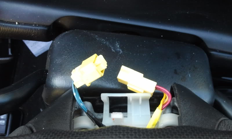

-Now, there is a cap on the bottom side of the steering wheel, you need to take that off. The easiest way to take it of I found out is by turning your steering wheel 180 degrees from dead center (upside down)
-The clip for the airbag is in this plastic slot thing
-Take it out
-Unplug it

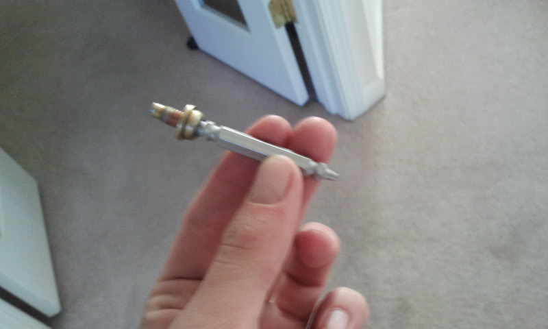

P.S. Now some people (i.e. me) might have trouble with those dam torx screws. They strip like they're made out of butter, I learned that the hard way
. Don't worry, your life is not over, I promise, there is a solution. I used a ProGrabit kit. The kit is a drill bit and an E-Z out in one. More specifically, has the drillbit at one end, then the corresponding reverse filament at the other. So you drill a hole, then you put your drill in reverse, switch the drill bit to the e-z out side and hit it. You should end up with something like this:
Then when you're done with the project, either get a new screw that PROPERLY FITS!!! or kick your drill in forward and the e-z out should leave the screw right in there. That's what I did because I ddint have a different screw and I'm definately not taking that thing apart anytime soon
