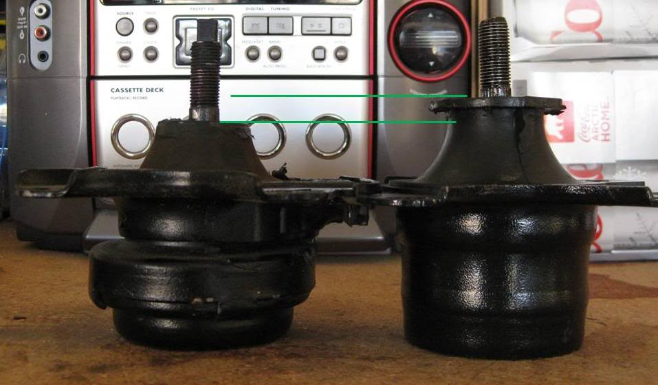

After many months of troubling chassis vibration in my 04 DX Coupe I finally solved the mystery. If you are experiencing a severe vibration at start up and during idle, and you drive a coupe, you might find this to be your problem too. Here is what I found...
There are two different left side engine mounts, one for the coupe and one for the sedan. When I had my timing belt changed at a local shop, they installed a replacement mount from Westar (pn 9016). The Westar mount does not differentiate for coupe or sedan. Turns out this part doesn't work well on the coupe.
After several weeks of troubleshooting, including changing the three other mounts (which were all in various states of degradation, the front mount completely shot), cleaning the IAC and TB, and considering more extreme measures, I finally did a simple check of the left side mount. The check consisted of loosening the bracket screws (engine supported by jack) and starting the engine. The vibe was completely gone. I then ordered the OE coupe mount, installed it, and the vibe issue was remedied (I know, I know....always use OEM).
In the photo below you can see the difference between the sedan and coupe mount (green lines, coupe mount has the taller profile). The issue with the sedan mount is that the shorter profile allows the L shaped mounting bracket to rest on the chassis, transferring all of the engine vibration directly to the chasis.

There are four mounts, one near the fan belts, one on the other side, one in front down low (usually always broken), and one that is at the back (remove air box to see it and it is a b*** to replace). Use search function for more info. As 04 HC says, use OEM. After market mounts are also not sized right for installation and you will run into this problem at the worst possible moment. If you need more info, please PM me.

From Majestic Honda... Sedan: 50821-S5A-A07..... Coupe: 50827-S5A-003

weird, wonder why they'd be different, coupe and sedan front end is pretty much the same, no?
Old Dec 31, 2011
Posts: 15,190
Likes: 1,609
Re: Tale of Two Engine Mounts
nuff said
