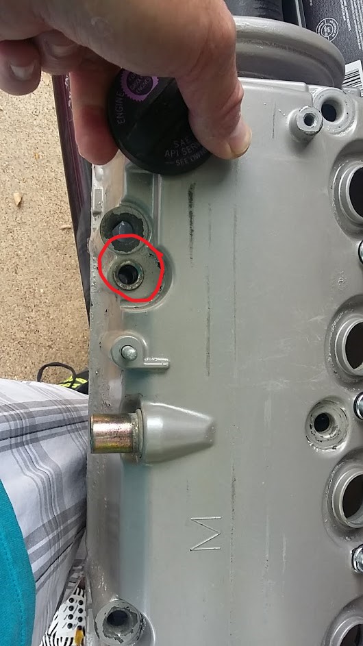

One more quick question, I got this car with the valve cover off, the timing belt broke but they didn't replace the valves, so I don't know what went in that hole next to the bolt hole. I got a head gasket kit, timing kit, all new 16 valves, head was milled a little, valves lapped in, should put it back to running condition. Car was free too, 180K body needs a front fender and skirts, but all in all very fixable. PO didn't know ****.

That's the dipstick hole

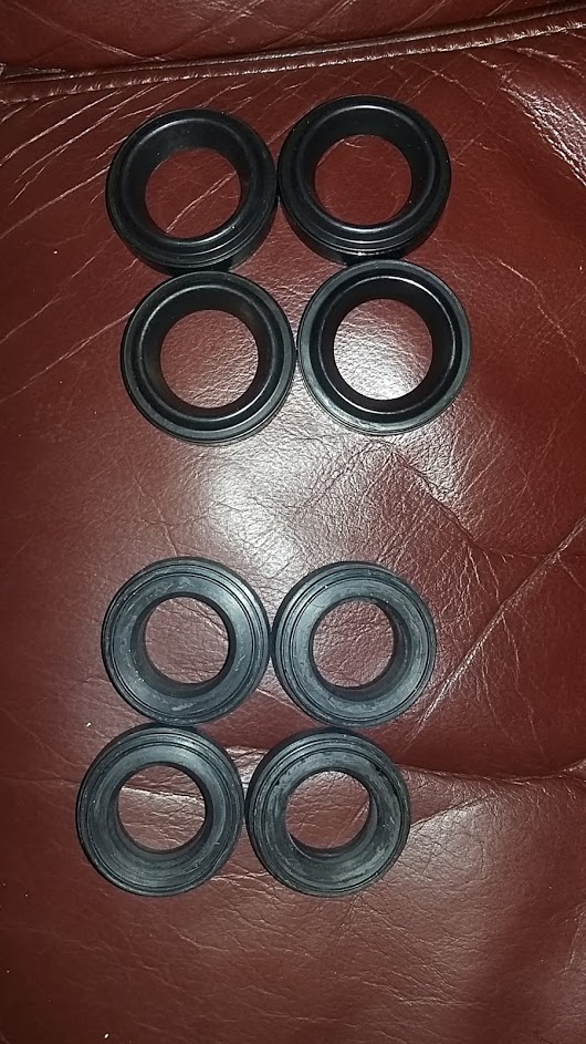

I'm a simi-retired mechanic with no experience with Honda cars. So I got these 8 seals, I know the 4 hard ones are the spark tube seals but what are the softer ones for? Also I got a gates timing kit with WP< the new tensioner has a wire loop on it, what purpose that serve?

The other 4 are for the ignition coils, they replace the gaskets on the base.
