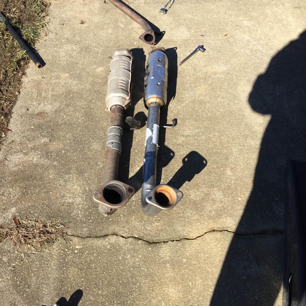

Now comes the fun part. The nuts that hold the two pieces together are so rusted I had to get a little camping propane bottle with a torch on it to heat the nuts and then break them loose with a 14mm socket. I heated each nut for about 30-45 seconds and then was able to stand on the pipes and break the nuts loose and get them off.

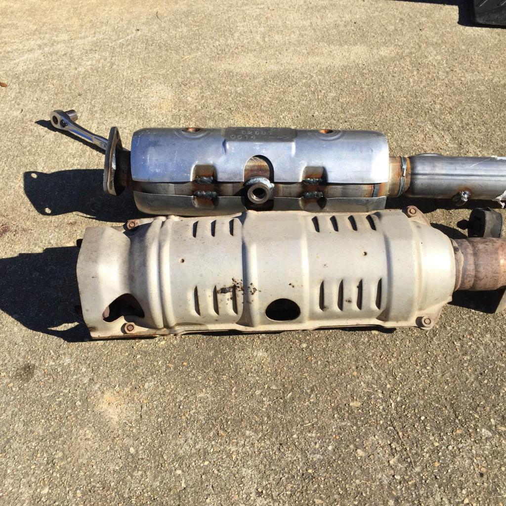

I got a Walker #82681 which a CARB certified CAT. From much of what I've read on the site, an OEM replacement is the best thing to get but it's also the most expensive ($700). Next is a CARB certified which is still costly but not as expensive ($350-400). Then there's cheap ones ($150-200) that are likely to fail soon or not keep the computer happy so you'll get a CEL.
The new one fits well and has the O2 sensor holes in exact same location.
