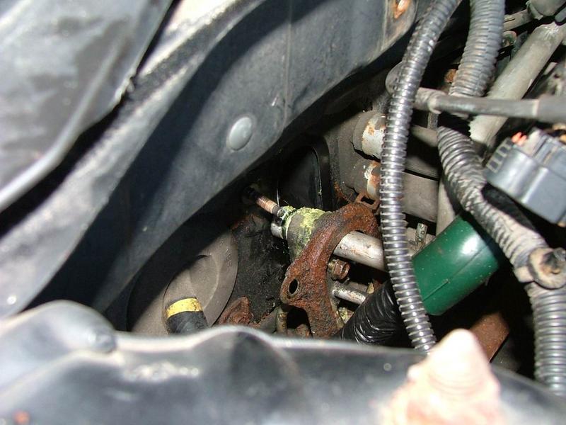

Turns out, gaining access to the evaporator isn't too bad, once you've learned the hundred ways not to do it. It looked it was going to be a pain to replace and I was thinking of skipping it, except that the threads for the line to the evaporator had gotten galled up.
Name:	goobered threads.jpg
