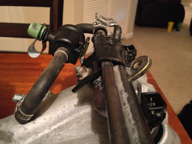

Once you acquire your Y8 manifold, remove everything so it looks like this. The injector rail post that is circled in red you will remove because you can't use it. Also you need to cap off the port next to the throttle cable bracket and the side exit of the Y8 coolant port which you are going to turn into EGR for the D17.

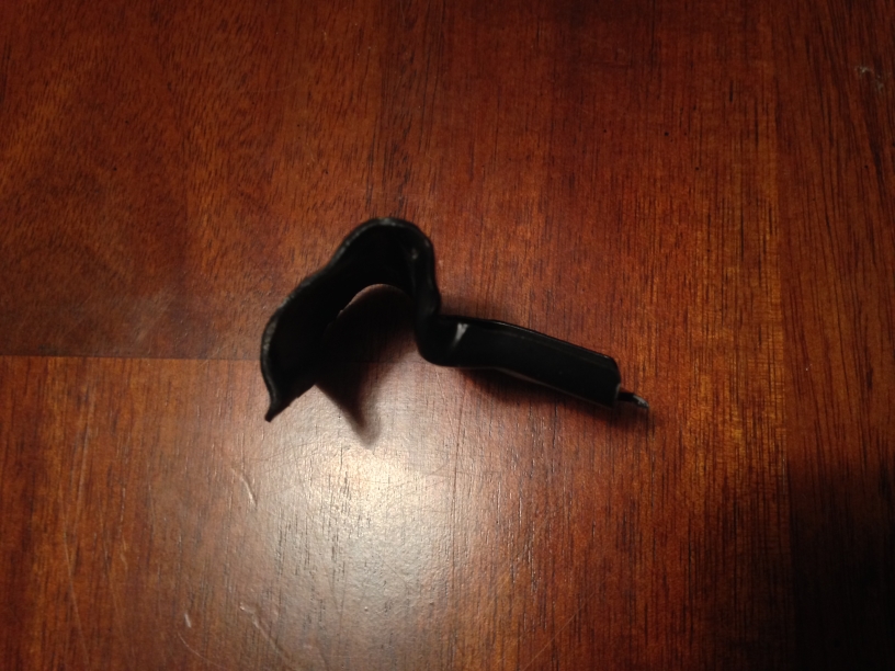

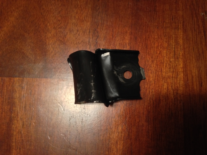

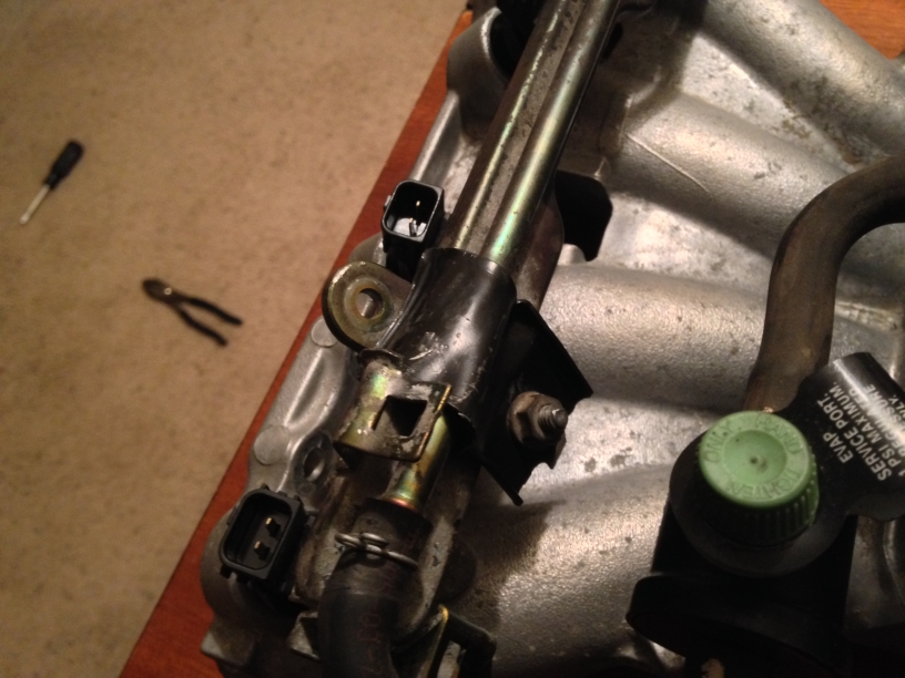

In order to fit the injector rail snuggly you will need to think of a sturdy piece of metal to bend into shape for the existing post you will mount it to. I used a spare throttle cable bracket that holds the line in the engine bay. I bolted the one side down with the rail on and hammered/tapped the bracket into shape to mold to the rail.

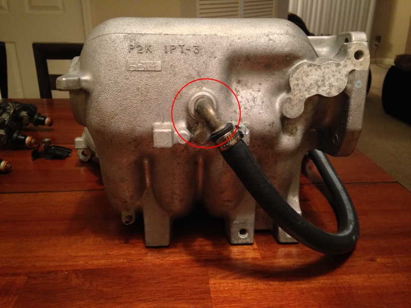

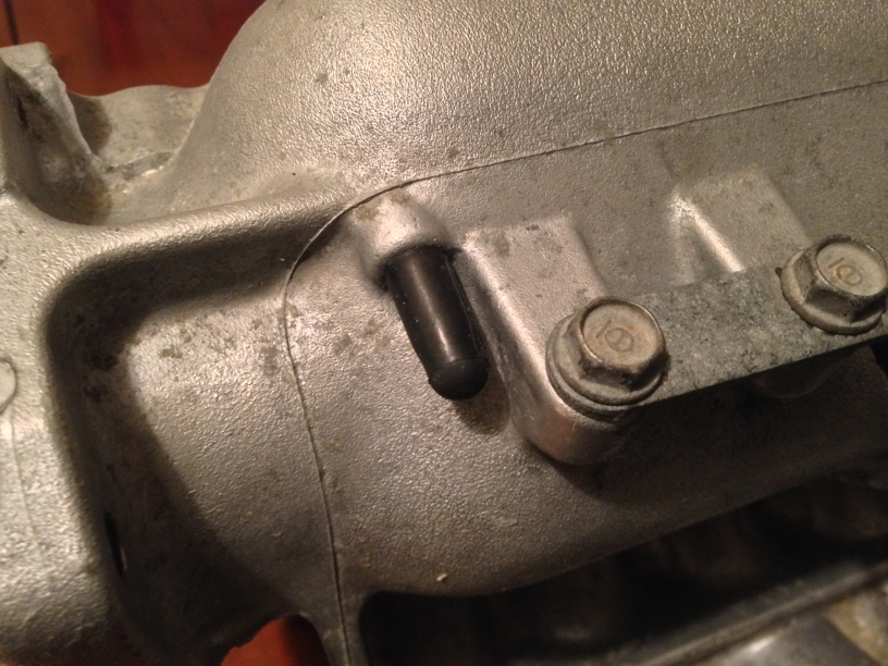

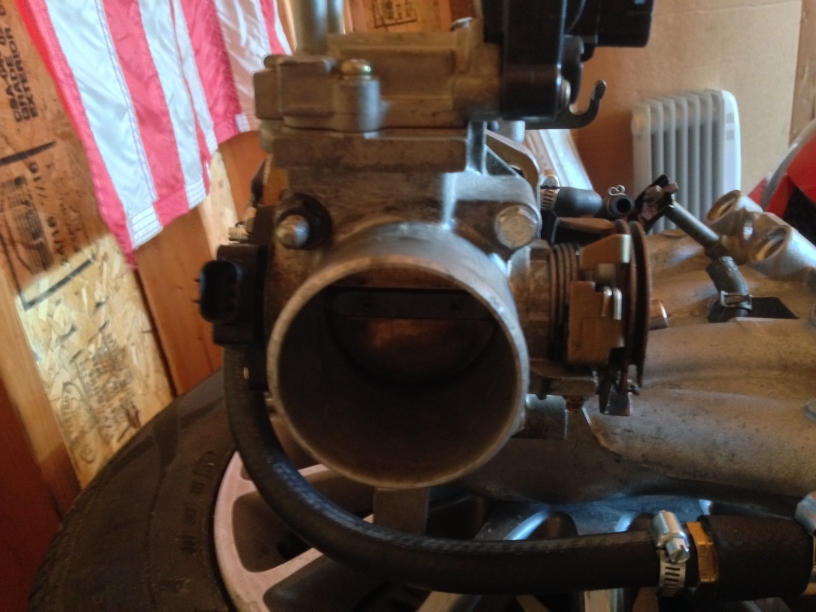

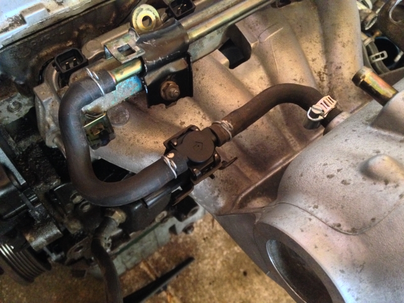

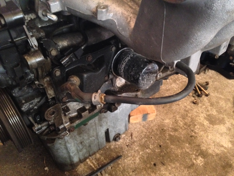

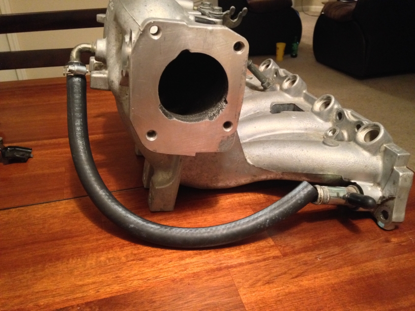

Next this is how you are going to hook up your PCV hose to the manifold. This is where you will need the 1/4-1/8 barb/threaded adapter (double check that those sizes are right when you buy it to fit the PCV hose and a vacuum line). Simply place the existing PCV hose side on the threaded side then the barb side put the vac line to the port on the manifold.

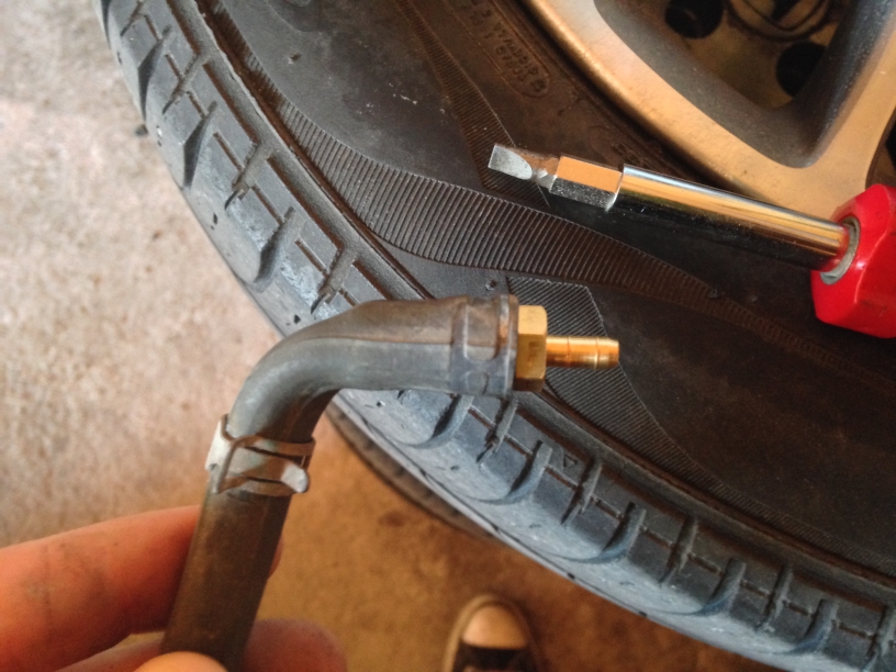

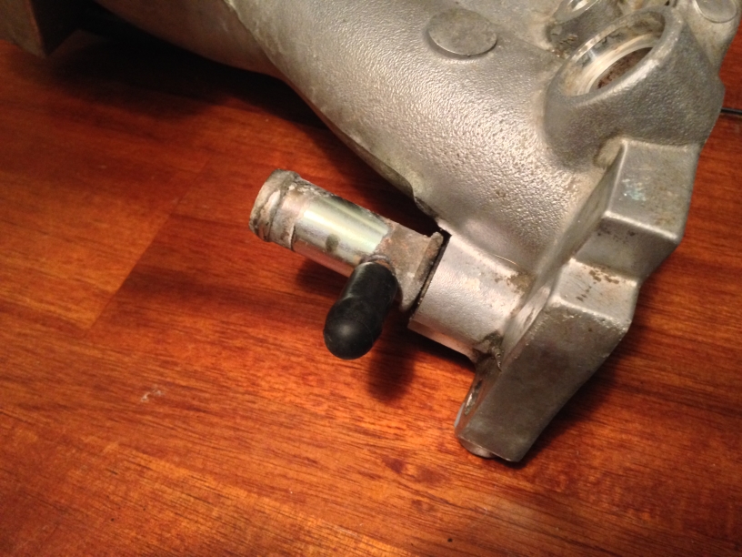

You are going to make the port to use EGR buy using your Dremel with the high speed grinding wheels to make a ramp like the picture with the red mark that way the head's port will line up with the offset of the coolant port on the Y8.

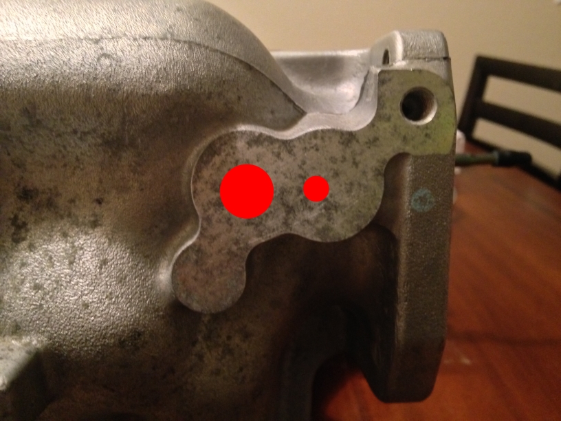

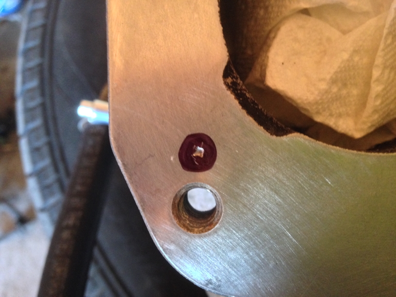

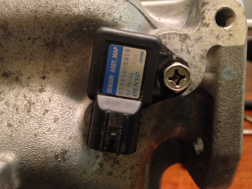

This is where you will place your MAP sensor, I eyeballed this but you want a drill bit the same sized as the nipple on the MAP to drill where the big red dot is, then you are going to drill a smaller hole to use a bolt to tighten it down. You will need to thread this hole for the size of bolt you will be using. My sensor looks a little crooked because I messed up the first hole, so like I said measure twice, cut onece.

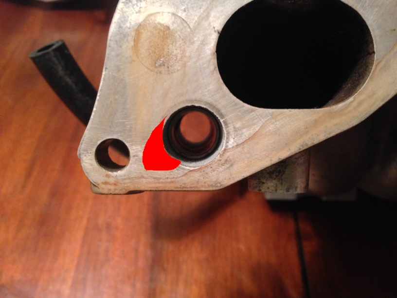

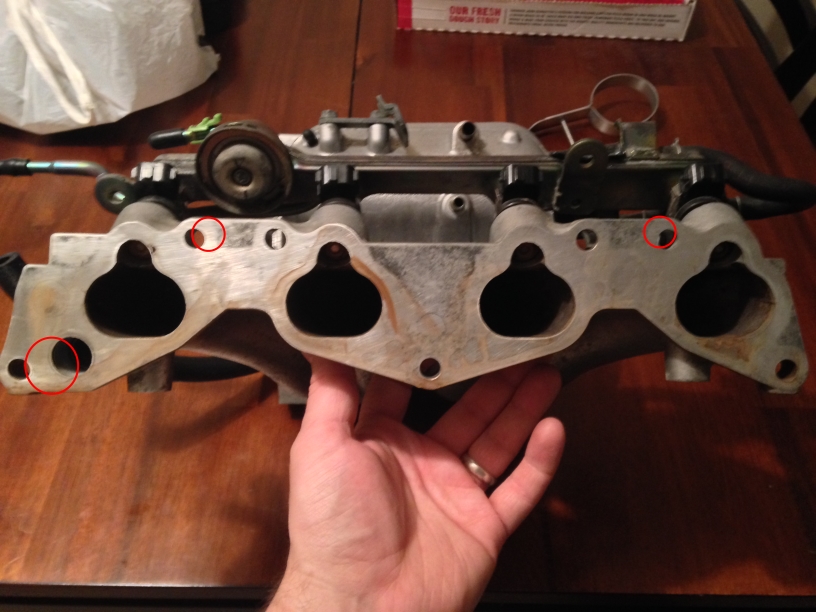

Next if you put your D17 intake mani gasket lined up on the Y8 mani you will see what holes you'll need to expand/widen. Here they are circled in red. The lower 3 holes will line up just fine with the stock stud positions on the D17 head. The EGR is also circled here indicating where you grinded away in the step earlier.

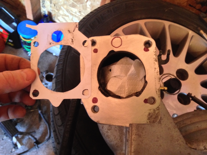

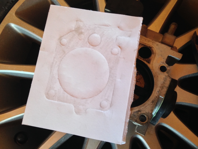

For the throttle body now take a thick card like paper, place it on your D17 throttle body and rub a quarter on it to get a outline of everything to use as a template for drilling on the Y8 manifold.
Cut out the holes in the template and line up the throttle body port with the large port on the Y8 mani and then use a Sharpie to mark where the bolt holes and IACV port up top will go.

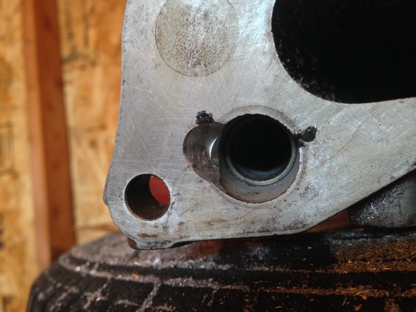

For the injectors to seal (I don't have a pic at the moment but I'll try to get one later) you are going to take the D16 big black gaskets that are in the manifold injector cups and put them on the injectors, then place a o ring that size underneath, then put a o ring the size of the stock orange one above the orange one. I also put a small amount of grease on it to make a good seal. Place the rail on the mani and push down the big D16 gaskets on the injectors down. Then bolt on your bracket, the EVAP sensor will also be mounted like in the picture just be sure the arrow is facing towards the manifold. Now if you need to pass emissions (I don't in NE) you will need to put the EVAP service port on, it's the thing with the green cap. The whole series will go Fuel rail---Hose---Evap Service port---hose---Evap sensor---hose---intake manifold port.

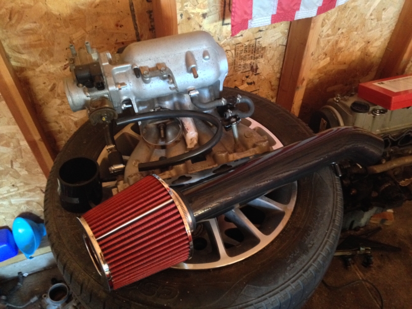

This is the D16 ebay intake I used that you will need to cut down to size.

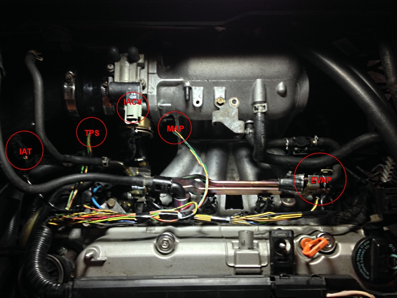

Next open your wiring harness where the injectors clips are at and just re-route the senor plugs you need so they can plug up on where the sensors are now located, TPS, MAP, IAT, EVAP and you can use the stock wiring locating for the IACV.

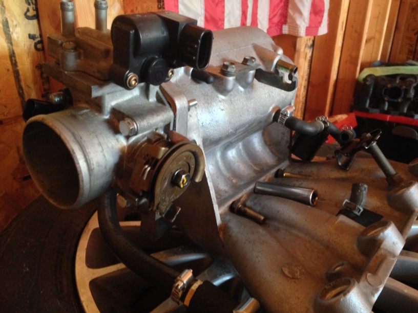

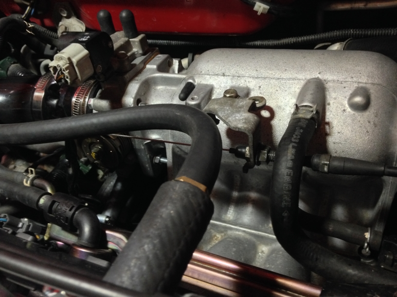

Hook up your throttle cable. Bolt on your D17 throttle cable bracket like in the picture.

From the walkthrough on this post..
MAP sensor MAP sensor
big red dot big red dot
is
So if that step was not done well...
This port located on the back you will need to stick a screwdriver in to rotate it downwards for your EGR routing you are going to make. I angled mine a bit toward the port so it was a little less extreme of an angle the hose to go to. In the second picture you can see how the hose is going to route to each port. On the coolant port side you need about 2.5 inches of 3/4 hose, then you are going to place the threaded side of the 3/8-1/2 barb/threaded adapter into the 3/4 hose side then the 3/8 hose from the barb side to the L port o the back of the manifold. Use hose clamps accordingly.
Next I used the drill bit I was drilling with and a hammer to punch a pilot hole so the drill won't dance all over the surface when you try to drill it.
With your holes drilled grind a ramp at a 45 degree angle going into the throttle body for the IACV port.
Use the stock D16 throttle body gasket, cut holes in it to fit the new bolt hole positions and the IACV and mount your D17 throttle body. I used a stud for the upper left, the rest I bought new bolts that where about 3/4 on an inch longer than the stock D17 bolts. I also used washers and a lock washer for added peace of mind.
And here it is complete, I also fabbed up a way to fit my K&N heat shield with the ebay intake and AEM dryflow filter.

FYI a 70mm throttle body will not fit on this intake without some major mods...
I went with this TB because of having a turbo.
Also, i had to cut the wiring connector to the TB sensor to fit....
Had to Bore out the intake hole
Made a Flange and had it Tig welded on
70MM TB now fits.

What did you do with the EVAP sensor??
