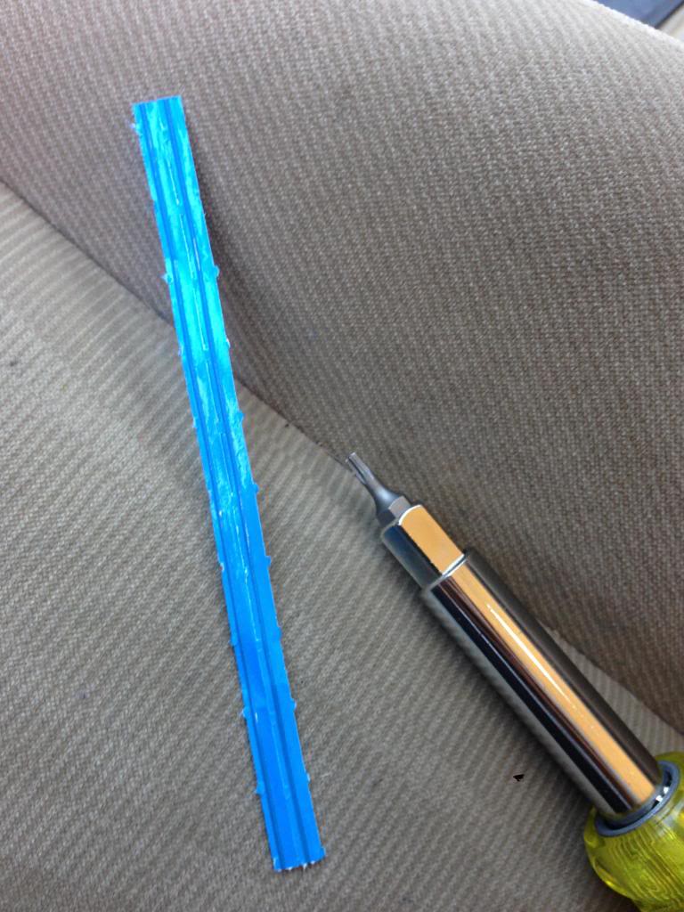

Materials
1. Twisty-Tie Bag Ties. ( Seen in the produce section )
2. Torx T-15 ( Correct me if I'm wrong. I was using my Klein 11-In-1 , which has 2 Torx bits in it that are common to the Electrical field but I forgot their respective sizes. I believe its T-15 and T-25 )
Procedure
1. Disassemble driver-seat seatbelt buckle
I believe this is a T-15 Security bit. You can use a normal torx and if you keep even pressure on the center, the coarse thread screws will come out- doesn't take much.

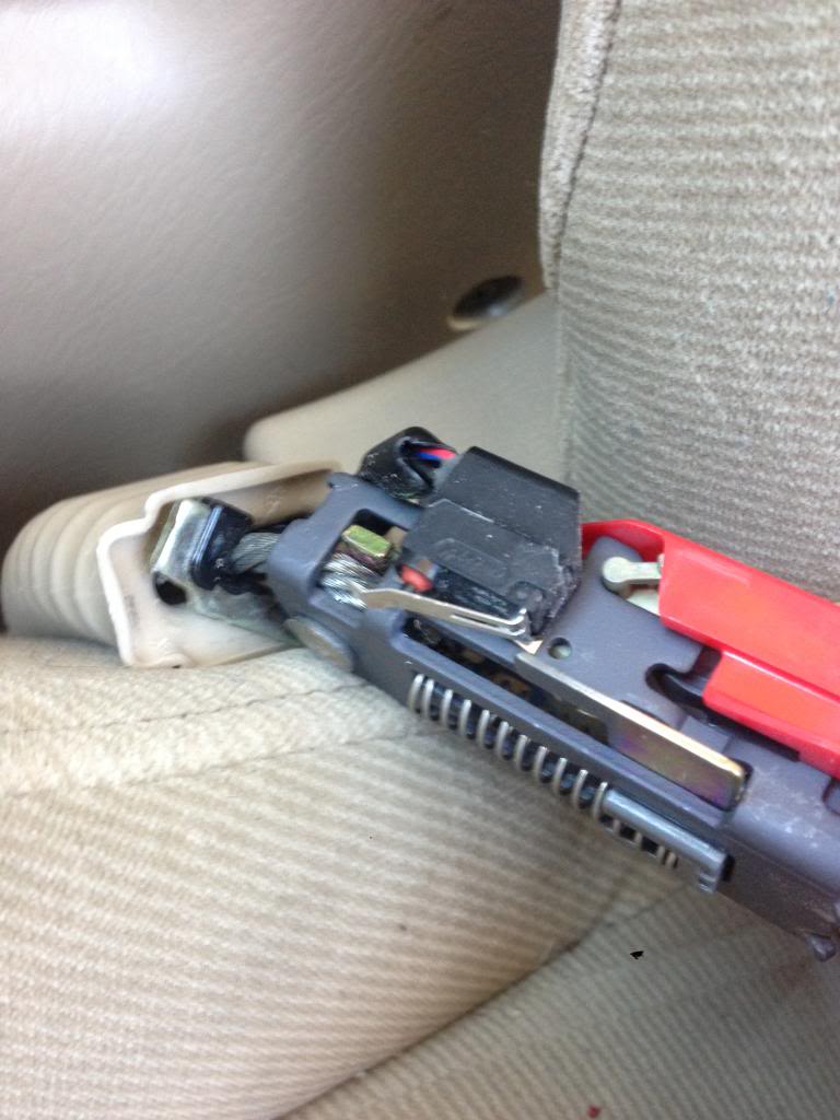

Pop the cover down and out to remove it. To remove the rear side, slide the base out of the molded flex arm it snaps into and push towards arm rest. Lift the rear cover off the guts.
2. Expose lever switch
Pop the mini lever switch out of the metal clamp it snaps into. You can just wiggle your finger under it and it'll pop out. You may even be able to grab it and lift it out with two fingers as well. Mine just popped out after a loosening wiggle.
3. Semi-Permanently "Close" the switch
Strip a twisty-tie / bag tie of its paper or plastic sleeve and expose the thin metal wire. ( Free fingernail strippers! ) Hold the lever down "closed" with your opposite-hand thumb and wrap it tightly towards the shorter "fulcrum" end.
You should be able to make two rotations before you have to twist the sides back together for a tight connection.
Tuck the twisted end neatly into the switches molded plastic cavity. Rotate until knot slides into a cavity on the switch ( This is just to keep things neat ).
To remove any extra slack, slide the "loops" towards the fatter "Effort" end of the mini switch.
Testing
Be sure the switch has no motion and doesn't click when you apply pressure to the lever. This indicates switch is closed successfully.
The thin wire should easily clear the switching arm that engages when you DO plug your buckle in. Be sure to test for this as well.
Turn the key on to ignition ( II ) and enjoy the blissful sound of fuel pump priming and relays for car bits clicking.
Snap the switch back in and covers back on. Tighten screws till they stop around OR before hand tight. If you don't have a security bit set, you will have a harder time getting these out later- for whatever reason.
