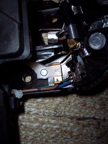

Yes, it does. Actually there are 5 wires when the stock latch have two. I only need 3 wires and the other two are left alone. I just cut the connector off the latch and use spade terminals. It plugs in the other connector that goes for the trunk light. I added a quick-disconnect terminal for the power trunk.
The unused extra two wires goes to another switch inside the latch. The brown wire on it is a switch that the original latch have and is what I use. The other switch just below the brown wire are left unused. See photos.

Originally Posted by GoldHCH2003MT
The part number 74851-S84-A41 is confirmed. Attached are the photos of the new package, original latch, side-by-side latches and newly swapped latch on my Civic.
I've run into what could be a problem with 74851-S84-A41. It doesn't have a connection for the existing trunk light. I'm not sure if it's the same with 08E49-S84-100H. How am I suppose to tell the light that the trunk is open or closed if I can't use the existing connector?
CIVICF5, just following up with this problem you post. Were you able to correct the problem? I am getting ready to try this myself.
