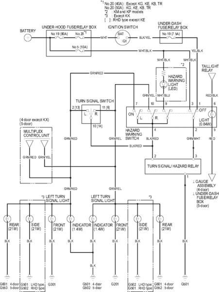

here is the wiring diagram for the turn signal/hazard lights
should be an attachment
that's only the turn signals. if i remember right, i think it's the RED/YEL wire that has power for the parking lights. you'd want that to go to the 85/86 terminal of the relay. i'd HIGHLY recommend putting a switch in line with that though. if you leave the switch on, the fogs will come on with the parking lights. however, there may be times you need to turn them off.
